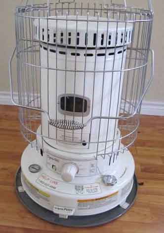

Her's a picture of a Dyna-Glo 23000 BTU Convection Kerosene Heater

they sell them at Lowes and at Tractor Supply (for $129) and on both websites the reviews (about 50 between the two stores) all rate it 4 and 5 stars. many of the reviewers mention that, unlike the old kerosene heaters, it is completely odorless except when it is shut off - then it can smell for 10 min or so. my place is just 12x16 with a loft. for a number of reasons i can't put a woodstove in for a year or so and I'm hoping this will get me through the winter. For those that have one (or one like it) is there any problems lighting it when its cold - like 10 or 20 degrees.
i'm going back and forth between one of these and a Mr Heater Big Buddy. leaning toward this kerosene one.

Ooops, I guess my google search was too quick. We have a different type. Ours is a "torpedo" style-forced air 70,000 btu with a fan and it spreads the heat out in all directions instead of a blast straight out. We put a metal cookie pan on the floor directly under the heat so that it doesn't scorch our sub floor.
Sorry for the wrong information. As soon as I saw what TomChum posted I knew that was a different type.

I used one like you pictured for several winters.
Kerosene heaters do smell at start up and shutdown, the burn between those 2 points is clean and intense.
If soot is coming out of the top the chimney, it is not seated correctly.
Use the scented wick oil and keep the wicks clean and free of creosote buildup. Creosote is not a problem if you use good fuel and have wick set at blue tipped flame burn.
If creosote builds up on the wick (hard brittle caramelized tips), do a quick burn outdoors and use pliers to break up creosote.
Keep in mind that any flame source is burning oxygen that you also need (and unventilated creating carbon monoxide), so using one while you are sleeping is not being minded.

Thanks for the compliment but that may have been intended for somebody else - not sure I have any decent pictures of our shack on here. But I'll take the compliment anyway. I'm 99.9% sure that's the brand and the output - it came from Lowe's maybe 7-8 years ago and looks identical to your picture. I think there are still a few brands but they're essentially the same. I was over last weekend and could have checked. Next time I'll try to remember.

We have that exact unit. It does work for smaller spaces and I've used it to supplement our propane heater on start up in cold weather.
The main problem I have is the wife doesn't appreciate the kero smell and she says it leaves a film on everything.

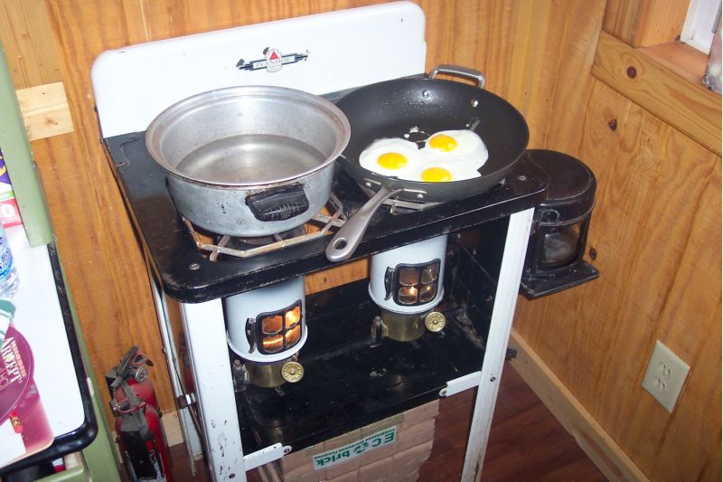

# Posted: 31 Jan 2017 12:16pm
Daddy2,
We use the Dyna-Glo sometimes, works great. Used it in our work-week home one time the power was out, kept our 2200 sf house at 55 degrees with some help from our fireplace. However, I rarely use it at the cabin anymore.
Why?
'Cause I keep it in my shed and would have to drag it out.
When I need to supplement the woodstove, I light my kerosene 2-burner range. Uses similar wicks to Dyna-Glo, but has two burning versus only one. And the rest of the time, I cook with stove, also using Coleman oven over one burner at times. You can find these kerosene ranges in 1 or more burner configurations, some with built in oven. You have to cook anyway, right? Available at Lehmans, etc. Pricey when new, though.
If your two kids are younger, you might also consider the safety of a kerosene range versus propane. My boys are now old enough not to turn stove knobs willy-nilly, but I would have worried about a propane stove knob being turned on and unlit in presence of lit wood burning stove. Boom!
If you do go with the Dyna Glo, keep in mind that "depreciation rate" of a new kero heater. I see these often little or unused at garage sales for $10-$20 off season. Check the wick condition first, as a burn-out wick would result in extra cost and effort.
