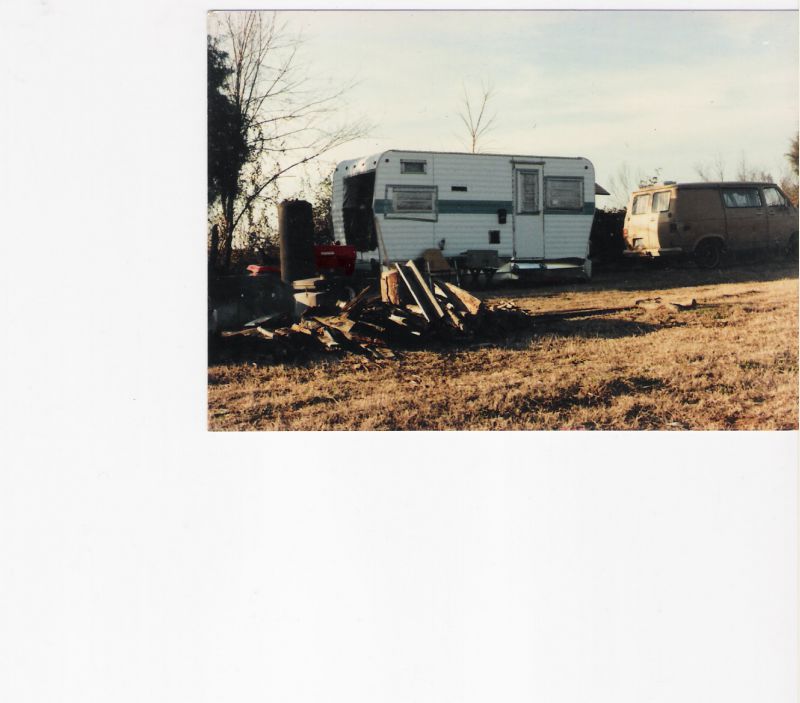

 years ago 1984,when i just had "land" i found a old "Gas" water heater it had a pin hole---i patched that.stripped all the outside stuff off it.another 12 volt water pump water into tank (power from Van house battery),..it held water.put it up on blocks-fire under it--heated it, garden hose out the drain--to the bottom Drain of my Camper trailerGravity Flow..RV pump that was allready in the camper--to the shower-did this almost 2 years.till i got electricity.
