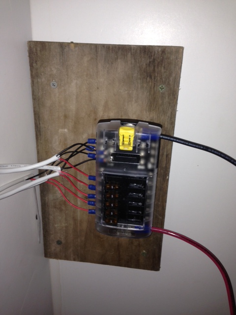

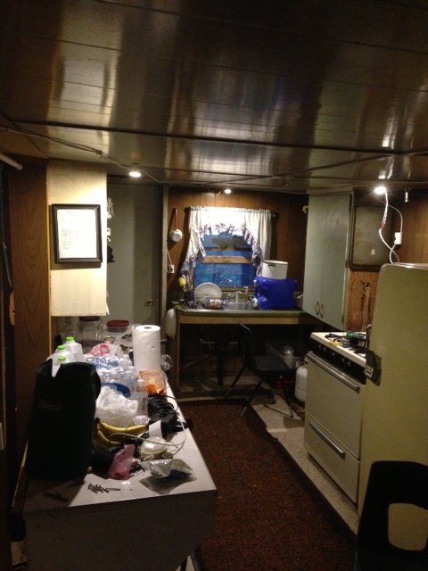

 Tom,
 Thank you for all your help and for answering my many questions about installing LED lights in my hunting shack.  I ended up putting 6 lights on 5 circuits and couldn't be happier with how much light those little LED's put out!  It's so nice to just hit a switch and not have to worry about propane!  Here are a couple of pics of the panel (marine) and a shot of the kitchen area.

 Looks great!
 If you have a multimeter with an amperage measurement, what is the total amps (and volts at that moment)?

 I wouldn't have a clue on how to check amps or volts!  I don't have a meter.  My father in law has one...do you test at the pos/neg lead going into the fuse block with all of the lights on at once to get total amps/volts?

 nice use of the marine panel. that looks very tidy.
