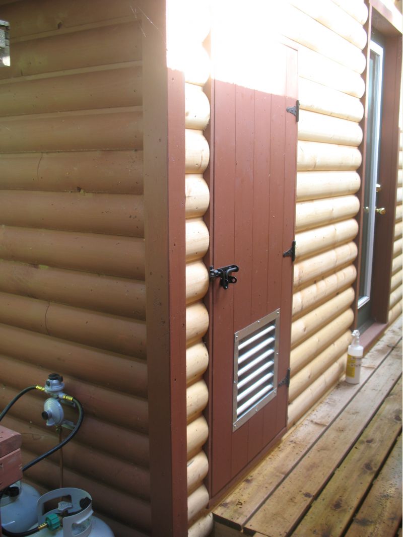

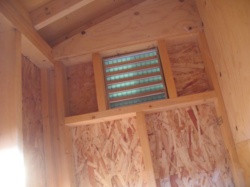

 I am planning to upgrade my water system by installing a tankless on-demand water heater. People seem to be pleased  with the Eccotemp L5.  I realize that they are intended for outdoor use or at least be mounted outdoors. I assume that this is because they exhast CO and require fresh air for combustion.  I have built a washhouse and added an attached closet sized space 3 ft. x 3 ft x 6 ft. accessible only from outside. I installed 2 - 12 inch square screen vents, one high and one low.  I'm wondering if the L5 can be mounted inside this space. I would love to hear from anyone with comments or experience with these heaters. I will be putting raw lake water through the unit and so plan to install an in-line filter to take stuff out. I shut down early October so won't be using it in the winter. I'm off the grid and so only have 12 VDC solar power and want to keep things simple.

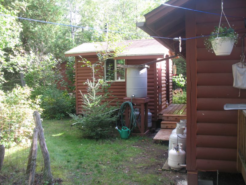

 Further to my last post on this topic May 2. I have bought my 12 VDC pump and pressure tank with the help of technical support at Shurflo. I had hoped to stay low teck with the Eccotemp L5 for a tankless water heater. I have communicated directly with Eccotemp and they say I cannot put the L5 in the closet as I had hoped (pictures in last post). They say the L5 won't meet my needs, is for recreational use only, cannot be plumbed into a cabin, cannot be used indoors. It needs to be mounted 1 foot side to side of anything flammable, 3 feet from windows or overhangs, 18 inches above ground, and 2 inches from the wall it is mounted on. Under no circumstances can it be located in a compartment of a motor home, closet or enclosed space. Communication was by e-mail because their phone is answered by a robot. They did reply quickly by e-mail but did not offer solutions or alternatives.
 I could hang it on the wall outside but I'm thinking the spiders and other insect critters will nest in it? I'm not concerned with theft, vandalism or freezing.
 So, anybody out there have any ideas or suggestions for a tankless water heater, low teck, or experiences (good or bad) with the L5 or other heaters. It's a simple cabin and I'll only be doing a kitchen sink, wash room sink and shower.
 In the meantime I'm going to play with the new pump set-up and get flow rates from the lake to the cabin

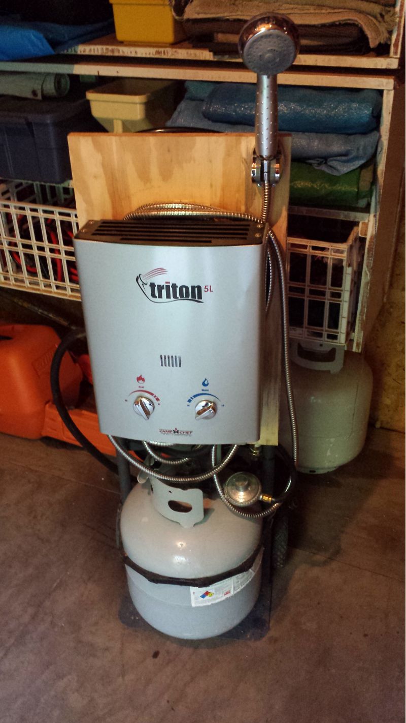

 I've had good luck with Triton along with the Shurflo pump as a portable shower.  I had an Eccotemp that froze and split a couple years ago even though I drained the unit.

 Thanks for these quick replies. The L10 I think is just a bigger version of the L5 both not vented. The Triton looks very similar to the L5. The thing that had me a bit worried was the heat and whether it presents a fire danger being in a 3x3x6 vented closet. My 3 neighbours would be a little ticked if I burned the 20 acre island down. Eccotemp did not address that. They just said don't do it. They did get back to me recommending 2 other units they have that have horizontal exhaust vents but 3x the price of the L5. I've got the L5 so will play with it. Like you FishHog, I may not get it all done now until spring. I'm a one hour boat ride to paradise and the weather can get ugly in the late fall. A new roof is now my immediate priority. I'll do a complete post once I get this water project finished.
