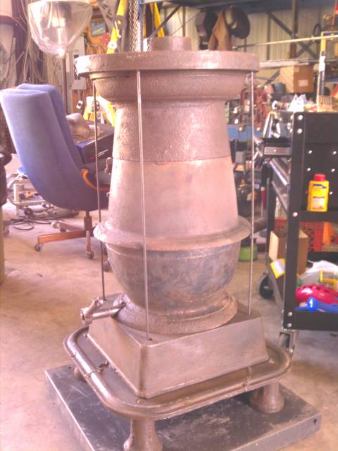

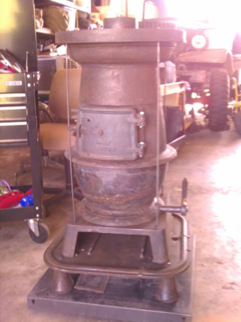

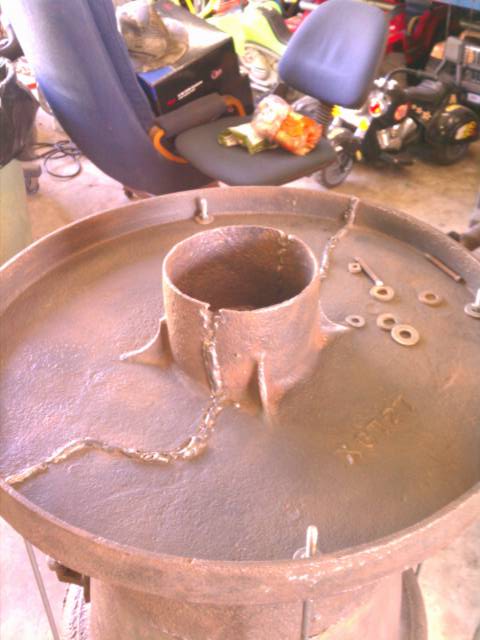

 A friend is refurbishing an 1800's pot-bellied stove off a caboose and giving it to us.. cannot wait to install it!
 He had to fabricate door hinges and the rods that go the length of the stove and hold it together. He made them as original as possible and now is working on an ash drawer.
