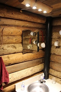

 I have propane lighting inside as well as 12volt LED lighting.  In a coup,e of places I have 120 volt lights hooked to my inverter.  The 12V lighting I used was from an idea I took off of this forum using the sockets and LED halogen bulbs.  I made a light fixture out of a piece of cedar to fit in with my log cabin.  The bulbs were expensive ($20) a piece but use very little power and should last a very long time. They are way brighter than I anticipated and light up my bathroom perfectly. Here is a picture of my light fixture:

 | # Posted: 28 Oct 2012 03:58pm Reply
 Look in the "General Forum".  At the top of the forum is a thread called "How to add pictures to Small-Cabin forum"

| skootamataschmidty Member
 | # Posted: 31 Oct 2012 02:44pm Reply
 12 v lights
 | # Posted: 31 Oct 2012 02:50pm Reply
 The switch for the vanity light is wired into an outlet box in this log
