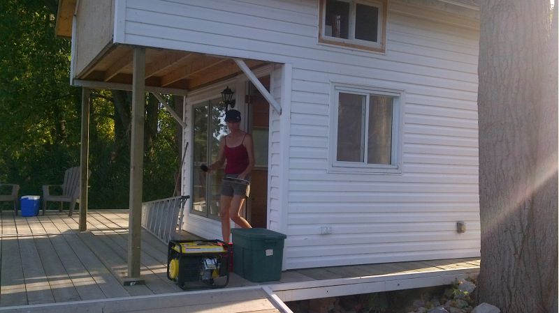

 I'm planning on adding a solar system to my existing 120V wiring at the cabin, what is the best way to accomplish this? I have the wiring design figured out to the invertor and planned on using a cable to the wall outlet (dedicated for this) but I read somewhere that this could be dangerous. The batteries are outside and I was going to be able to just plug the system in when I wanted to make the wiring go live. I also wanted to do the same thing with my generator. How do you connect to your cabin?
 In the picture, I have two outlets on the side of this building, the left one is a standard outlet but the right one is a male plug so that I could use a heavy extension cord from the generator to the cabin. I want to do this with the solar system too. Any thoughts?

 So far, it appears that my plan will work. I will switch between invertors depending on the load. For the most part, the load is very small, a light, radio or something with a weak draw. When I want to drill something I'll switch over to the larger invertor. As for the power entering the building, I have that male plug in the waterproof box that will feed the building circuitry.
 The solar system is light weight so far, until I know what I need to power up more high drawing devices. There is only one plug to feed the building so I can't mix up the invertor with the generator!  To be clear, the invertor is on the outfeed side of the solar panel and controller, batteries etc., to power up the building from the batteries to be used as a nice quiet way to enjoy the afternoon there.

 don't do the double-male cable.  Once you plug it in, the other exposed end is hot and a bad shock hazard.  Just wire it into your load center box using the appropriate breaker.
