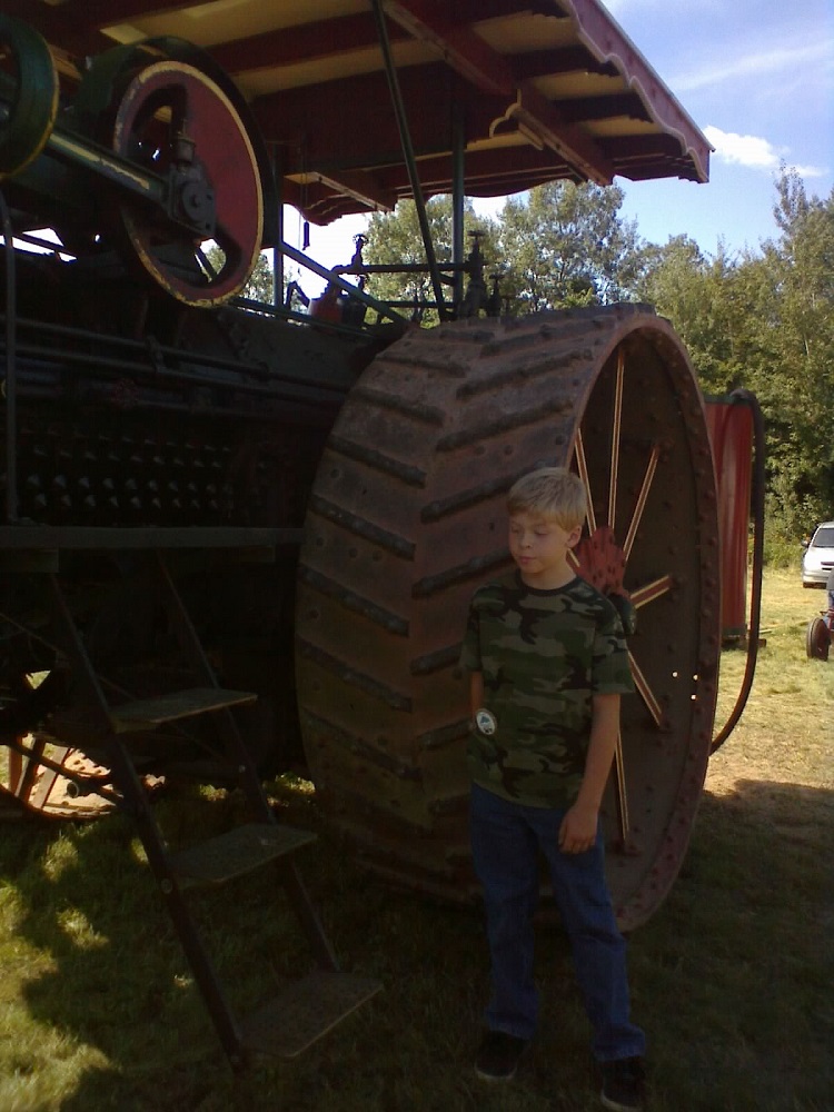

 How about steam power? I know I have way too much downed wood. With steam you get the ability to generate electricity, you get heat, you clean up the woods, and you can power some things directly, like a saw mill.
 Owen
