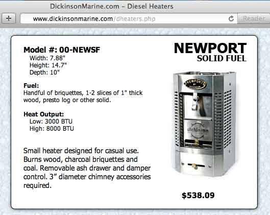

While on the subject of small stoves, see this marine woodstove, found in the diesel heaters section; a little solid fuel version for $538.00 3000 BTU / 8000 BTU. It's about the same output as a Lil' Buddy propane heater. Needs a flue to vent smoke outside, of course. Maybe OK for a 10x12 insulated cabin? (definitely too small for a 300SF)
Quoting: hitanktank http://www.dickinsonmarine.com/propane.php  Dickinson woodburning stove

Cool stoves, but remember they are SMALL, about the size of a 12-pack of beer! 5500-7500 BTU/hr. This is a small stove.
