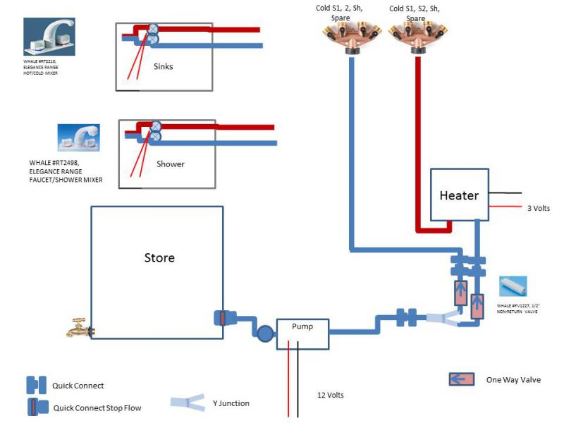

Ask away. many ways to skin a cat depending on needs, source of water power etc. I do not have pictures of the actual setup. At this stage. The diagram here is a simplified view of what I did because you need to determine how you will drain your system, whether you want to add a manual water pump (i did for the sink) and whether you want to use a pressure tank or not. In my case I skipped the pressure tank and used faucets with micro-switches to turn on the pump when needed. The pump can run with its own pressure switch or this can be bypassed. I would have to dig up the actual pump model but I got it with the L5 as a kit - make sure you have a good quality one so you can drive enough water through the L5 to have it start (there are ways to adjust the amount of flow needed). This system is not intended to be used with all faucets going at once. If you need a lot more use then you would likely need a larger pump and a pressure tank. This setup works well for me and my family - some dishes, wash up the kids at night and a rare shower (what is the lake for anyway!). My actual setup is a bit more complicated because I have added a manual foot pump in the kitchen and I also pre filter the lake water into the storage tank. All a bit labor intensive which is another reason why it was designed for limited use.

Well basically I'll be putting a 40 gallon water tank into the loft. I'll be using a pump to fill it from the pond. My cold water will gravity feed from the tank to kitchen sink, shower, and toilet. I plan on putting an L5 next to the storage tank with hot water to shower and kitchen sink. Every tap will have a low point with valve, so when I leave during the week the lines won't freeze.
I pretty much have it all figured out in my head, I just don't want to have to turn on a pump every time I want hot water. I want to just be able to open the tap and get it. I'd consider the L5 bundle if it makes the system easier to install/operate. How expensive and hard to setup are the taps with micro switches?

The diagram included some examples of faucets with built in switches (check out various marine supply stores for prices). On the other hand you can just as easily wire in a DC switch (even a timer) and "manually" switch on the pump at the sink whenever you want hot water. The PSI from the pump will kick in the L5 and provide hot water. How hard or easy this would be depends a bit on your current wiring but overall not tricky. In my case I ran 12 volts to the pump but used a relay fed from either of the faucets to kick in the relay and power up the pump. I use the pump for both hot and cold water to avoid the need to get water up into a loft (which needs a pump anyway). If you really want to do it this way you should be able to use a single pump with a Y valve and a couple of extra fittings - one way to pump water to the loft, the other way to pump the water to the L5 (depends on the capability of the pump naturally).

Seems to me you have two simple choices - 1, use a pump with a pressure tank which would give you a somewhat standard type of setup. Pump is always powered but comes on when the pressure drops in the tank. Pretty standard house system other than the source. You could split the hot and cold to use gravity for the cold but I don't see the advantage unless you have a power issue and this would make a difference. 2. back to the on-demand system where, when you turn on the tap a microswitch powers the pump (or a relay) and the pump comes on. This is a standard RV or boat type setup (although larger RVs etc use a pressure tank as well). All along I have assumed you are running 12 volts but realized that this may not be the case. In addition you need to consider venting the L5 as these are not specified for indoor use.

You don't actually need faucets with switches. Once the pump is powered it charges the water system and shuts off with is own presure switch. When you open the faucet or turn on the L5 the pump starts and supplies water until the faucet is closed.

Correct - the reason I like to use the switches is that should the system spring a leak it will not then cause the pump to run - likely overkill but as I said at the beginning there are lots of ways to set this up.

Minor correction - it is not a pressure drop that kicks in the L5 but a certain flow/pressure difference. When the faucets are closed the pressure on both sides of the L5 are the same with no flow. Open a faucet and that changes.
