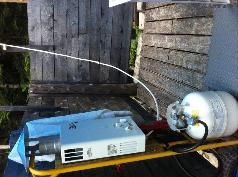

 This is our source of hot water. It's for our outdoor shower. We put it on the cart so it is easy to move and we can take it home in the winter.

 The photo I posted is the EZ Tankless 101.

 We only use it in the summer and the water is pumped from the lake into a 250 gallon holding tank on a water tower in the sun so the water is not very cold yet to cold for a nice shower. The heater is amazing. We use only about 1/4 a tank of propane in 3 weeks. Two showers a day for two people. The water can get hot enough to burn. It is preset so all we have to do is flick the switch.
 It sure beats the 25 years I spent bathing in the cold lake every summer!

 That is why we have it installed on a cart(we use it outdoors only). It's easy to take home and store in our heated basement.
