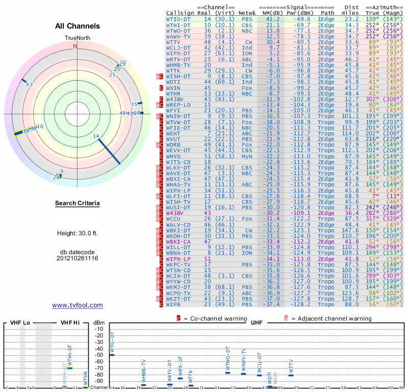

 I'm thinking about setting up a tv antenna at my cabin (there's only so many DVDs I can watch).  So, I went to www.antennapoint.com and input my cabin's zip code, and the site returned 16 channels from my zip code and recommended the ClearStream 2V (C2) antenna.
 I guess I have to climb 30' up a tree and install the antenna.  I also have to run at least 150' of cable from the antenna to the cabin because my cabin is in a gully, so I have to go 150' away to get to the top of the gully and up a tree.  My cabin's location is also mostly wooded.
 Does this sound worth the money, time, and effort?  What are your experiences with using antennas?

 I entered my address and got the same antenna recommendation
  I also noticed that the TV channels list was not complete for my area.
 www.tvfool.com might give you more info?  This site will show signal strength and direction for each station with your planned antenna elevation, so you can get an idea of what you'll be able to watch (strongest signals = most likely).  You can also see if there are any digital VHF stations (few in my area) vs UHF (vast majority) to help with antenna choice (UHF, VHF or combo).
 I get a number of digital UHF stations with very good reception-  I went for a UHF-only antenna (forget the exact one) with 8 elements.  I'm down in a valley but do OK.  Trees do interfere with my reception.  When the leaves are out, less signal (6 months of the year). When the wind moves the leaves, less reception.

 It can be done. You will more than likely need a preamp at the antenna though. TVfool is a good site. I know someone here who has an antenna on a ridge with a 500 foot run of RG11 cable down to the cabin. Preamp choice needs some guidance from an expert though. Too powerfuk a preamp messes any signals that are already very strong. That's about all I can contribute.
 Our antenna is 30 feet above grade, I run a small Winegard preamp with a cable run of 110 feet. The transmitters are about 40 miles away at an elevation about2200 feet higher. The antenna works good most of the time through the tree tops. I'd need 80 feet of height to get above the pine tops.

 The closest "metro" areas are Indianapolis, Bloomington, and Terre Haute, IN. Most of the stations come out of Indianapolis, which is also the farthest (45-50 miles) from my cabin. But, Terre Haute has NBC, CBS, and Fox, and Terre Haute is 35 miles away, which may be easier to pick up.
 So, in order for me to pick most of these Terre Haute and Indy stations, I'd probably need something that is directional, correct? Which means I'll be getting either TH or Indy stations, but not both at the same time.
 SE Ohio, I like the idea of a 30' tower, but to get to "high ground" I gotta get out of my gully which is probably 15' below grade and 100' to get to the top, and then I gotta run it up a tree, hence the long cable run.
 I'm just brainstorming here, but if I stick with the Terre Haute stations (CBS, NBC, and FOX), I might be able to avoid a cable run. My cabin sits on the east bank of a small lake, but big enough that I think the stations could come in unimpeded by trees. The Terre Haute stations are WSW from my cabin. Does this sound plausible?

 My 8-element UHF directional antenna cannot pick up the outer 2 rings on the chart, probably only the 3-4 most powerful ones shown.  Good enough?  You might get more with a higher and larger antenna?  It is a balance of viewing preferences vs expenditure, but you could do okay with a 30' setup but spend a bit extra for the directional controller/motor, as the signals are all over the compass.

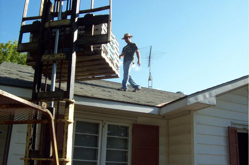

 In 2011 we updated our system at our summer place on the shores of lake Erie . We kept our old  30 ft. antenna tower and roter but added new coax , a new preamp at the top of the mast and a new flat screen TV . because of the lake we now get all the major network stations both Canadian and US plus PBS and TVO plus 30 or 40 local stations all around the lake ..from Buffalo and Hamilton to Clevland and Detroit. the trick is no trees .So my advice is go as high as you can afford and it should work great . Good Luck
