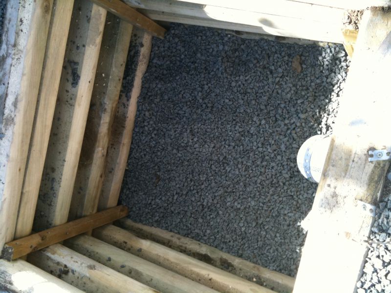

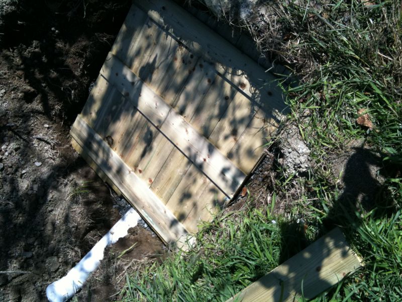

If you are permitted (and plan on checking) a grey water pit then the local municipality will be able to tell you what the requirements are. In my are the rules are:
52. Isolated dwelling without a pressurized water system: Where a privy serves an isolated dwelling which is not supplied by a pressurized water pipe and which is inhabited less than 180 days per year, grey water must be purified by a seepage pit built in accordance with the standards in paragraphs c and d of section 32, paragraphs c and d of section 34, section 35, and with the following standards:
(a) the disposal site must be of high permeability or permeable soil;
(b) the bedrock, underground water or any layer of impermeable or low permeability soil must be at least 1.2 m below the surface of the natural ground;
(c) the seepage pit must be 1.2 m in diameter or 1 metre square and must be 60 cm deep;
(d) the walls of the seepage pit must be built of
(i) unmortared concrete blocks in which steel rods are inserted;
(ii) unmortared stones between 15 and 30 cm in diameter; or
(iii) latticework wood beams.
Note that a seepage pit here is only allowed for a seasonal dwelling without a pressurized water system. I cannot speak on the winter use issue but I don't see why it would not work for limited use in the winter assuming a proper pipe slope, some insulation around the pipe and possibly a slightly deeper pit with insulation around the upper section and the top. none of this might even be needed.
Couple of photos of our pit:
Pit without cover
Pit without cover
Solid cover
