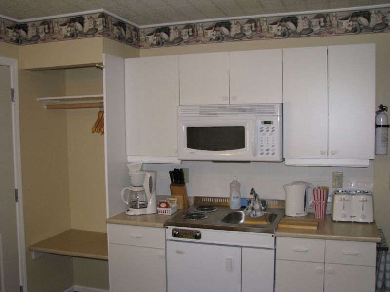

I am looking to buy this for my off grid small cabin. I am also going solar. I cant seem to find specs anywhere for how much power this uses. Any thoughts on how much I would need to run it all the time? THanks.

We use something similar to this in one of our rental units. Ours has a small freezer but doesn't have the storage on the side like your photo shows. Our guests LOVE it. We are not off grid though, so I don't know how it would fare without conventional electricity.
