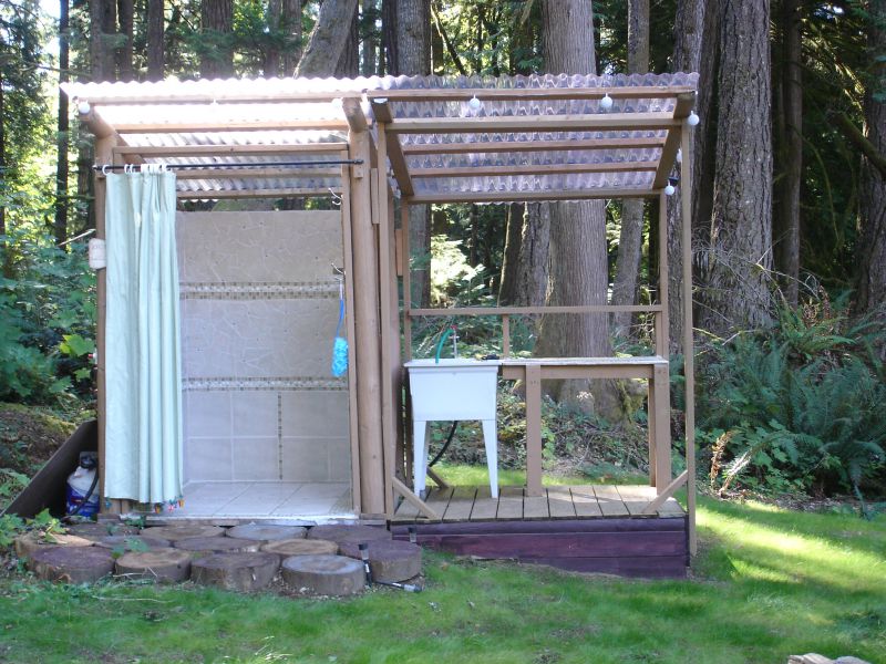

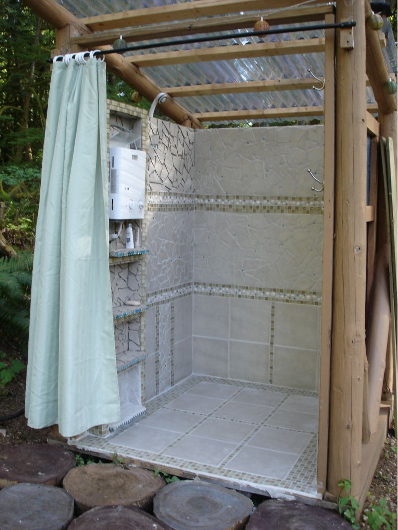

We have the Ecotemp E5 and our water comes right from a mountain spring below the frost level. It is freezing, and our shower is HOT!! I attached a pic of how compact it is. I have to admit, this is one of the best things at our cabin. Nothin better than a hot shower!

nicalisa that's a nice shower! Did you build it?

# Posted: 26 Jan 2013 07:49pm
Thanks Tom Chum! We did build it and then I did all of the tile work while my hubby did some other projects. We have added a washtub next door at the end of last summer and the new pic is attached
wakeslayer
# Posted: 27 Jan 2013 10:08am
Nicalisa,
Your shower is gorgeous. Love the tile work.
hitanktank
# Posted: 27 Jan 2013 12:35pm
that shower is so sweet
MJW
# Posted: 27 Jan 2013 01:28pm
Very nice!
Makes me almost wish we were putting our shower outside.....almost.
