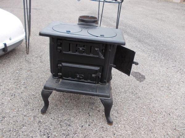

 I found this stove on craigslist for a great price.  What do you guys think?  Thanks for all the help

 Quoting: mjmmessina I found this stove on craigslist for a great price. What do you guys think? Thanks for all the help
 I think that is one sweet stove. I would love to find soemthing like that. In the mean time I think Coleman makes a small propane stove on top and oven bottom that looks like a very good solution. I have seen them in Bass Pro. I haven't seen any reviews of them as yet.

 I'm going to buy the little cast iron stove I posted.  I'm going to use it for occasional heat since I have unlimited firewood where my property is and keep the ventless propane.  I've been trying to research the stove and haven't found one similar on the internet.  Does anyone know what style you would call that stove?  Parlor cookstove maybe ?

 Box or boxwood stove.

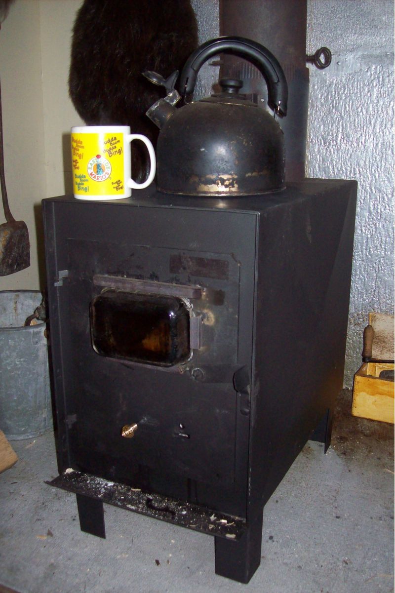

 just replaced the old one I had .it looked like a twin for the one above but was rusted out along the bottom, not safe ..wanted a glass in the new one  so I cut a hole in the door and covered it with a Parex baking dish 1.25 $ at the dollar store . have had 5 good fires  seemes ok  did't break ..got the stove at TSC 149.00$ not ment for full time use but good for cabin.  I'ts call THE HUNTER . 14 w x 22 d x21 h..

 I did some research and the cast iron cook stove from my original post was made by Jacobs manufacturing co from Bridgeport Alabama.  Anybody know anything about that companies wood stoves?

 The box or boxwood stoves i have seen or used are not airtight. They are hot burning but won't hold a fire for long. Was thinking maybe if you sealed the edges where they join with stove cement sealer they would work better.

 just to let you know , in case you might try my PIREX trick, a crack has developed after 2 weeks still workes fine , but i did go back to the $ STORE AND BUY 3 MORE DISHES ..5$

 Just a tip about Pyrex.  My parents had a similar stove and the dish was cemented in place.  It kept cracking eventually so I suggested no cement.  The stove was tight and there were no further issues with breakage.  I guess you have to allow for some movement with heating and cooling.

  I did cement it in, i'll try  that with a new dish..
