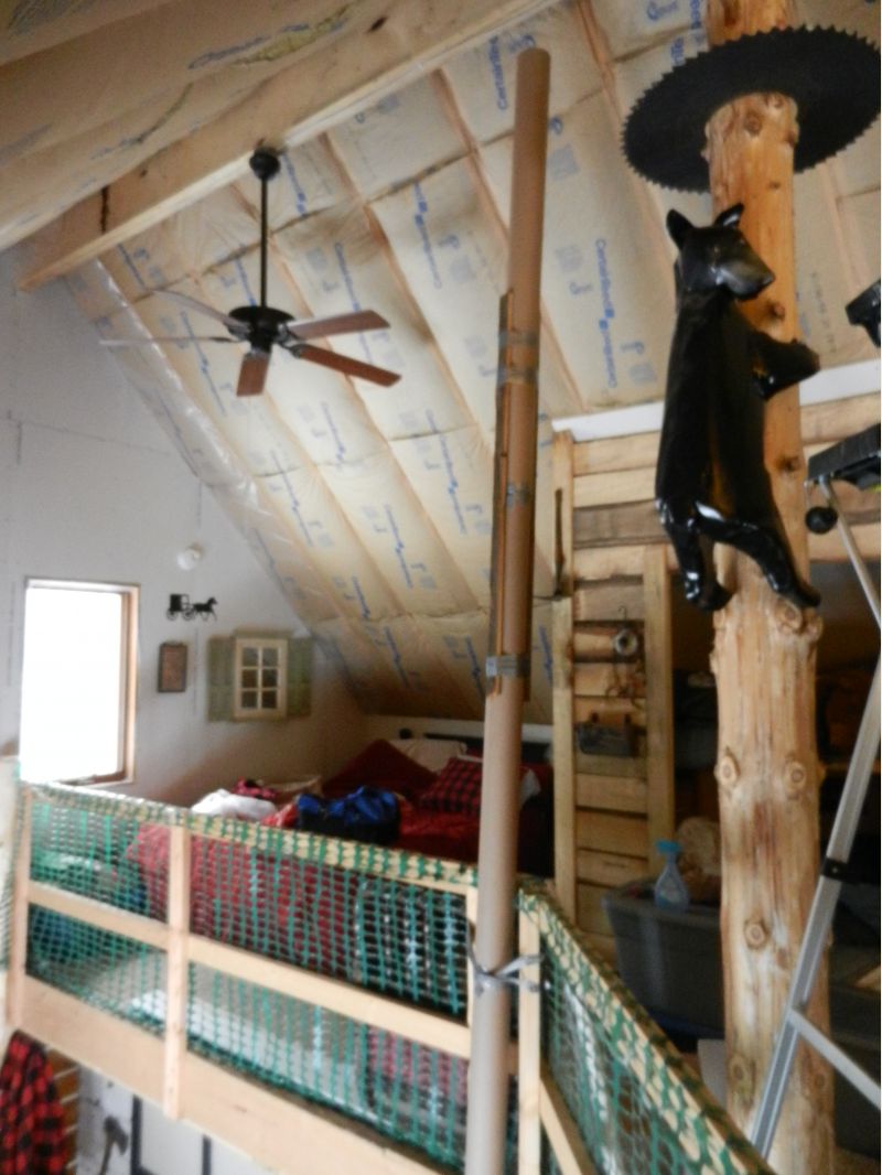

I thought I would pass along what we discovered while trying to move the warm air up in the loft down to our bedroom. We used cardboard tubes and a fan on the lower end of it. It did draw air, but by the time it made it thru the tube, it was blowing out at a pretty cool temp. I'm sure the length of the tube was way longer than we needed. it was also narrower than what we would permanently use. I think adjusting these things will help, so although it seems to be a failure for now, I think it is worth more experimenting with I'll keep you posted!
Here's a picture of our quickly rigged up tubing.
cardboard tubing
cardboard tubing

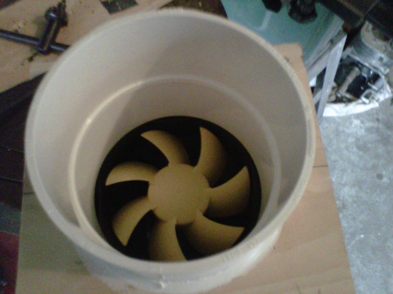

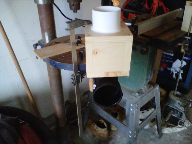

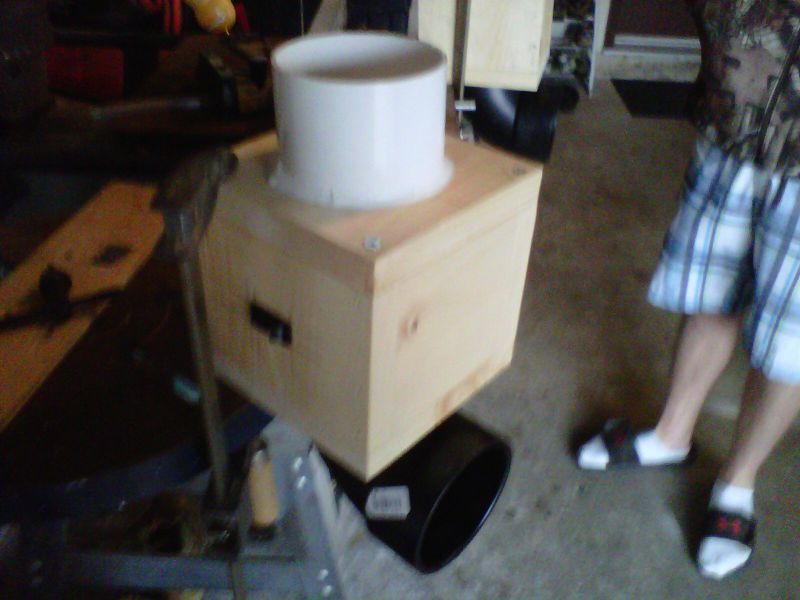

Here is the link to the heatstick sight I used. http://www.heatstick.com/_Heat%20StkBluBox.htm
I'll try to find some pics and post them when I get a chance. They heatstick sight used blue electrical boxes to mount the fans in. I made boxes out of 3/4 inch pine I had laying around. The fans I got at a computer store for about $5 each. They came with the silicone mounting pins. The switches were from canadian Tire and were only a couple dollars each as well. I glued an ABS coupler into the top of the box and then placed my ABS duct into that up to the ceiling. I cover the top of the ceiling with a computer fan wire cover to keep critters etc out of it.

# Posted: 20 Feb 2013 08:45am
Here are some pics. The quality isn't the greatest and they were taken after I made them at home. I do not have any as of yet of them installed. The piece at the bottom is a 90 degree PVC elbow. It fits in the bottom hole and I held it in place with two cotter pins. This allows me the change direction of the air.

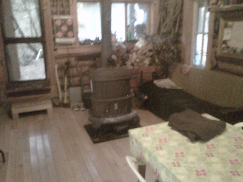

# Posted: 22 Feb 2013 01:34pm - Edited by: trollbridge
Quoting: skootamattaschmidty
The fan in that heat stick draws air off the ceiling and in so doing, it creates a draft causing the warm air trapped at the ceiling in the main room to be drawn through the vent hole cut in the wall close to the ceiling.
In our main room the ceiling is open to the loft though-it's like 20 some feet tall-so if we cut a vent hole in our bedroom wall it would only be catching the air in the middle of the space, but that is still warmer than the bedroom since the wood stove is in that room. Any thoughts on that?
Also, will it matter that the bedroom is small with a 4 foot door opening? Think there would still be enough draw thru the vent opening? Like you said Shabin-I don't want to cut an opening if it won't make much difference. Also not sure if it makes much sense to have the doors shut to create a draw...it's a bonus to still have heat with them shut, but I don't want to have to keep them shut most the time just to create a draw. know what I mean?
I get how the heat stick works. Their website explained it very nicely, didn't it? What is throwing me off is the vaulted ceiling.
I really appreciate your thoughts on this, and skoot, your actual experience helps a lot.
open to loft
open to loft
bedroom under loft-4 foot door width

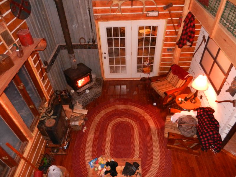

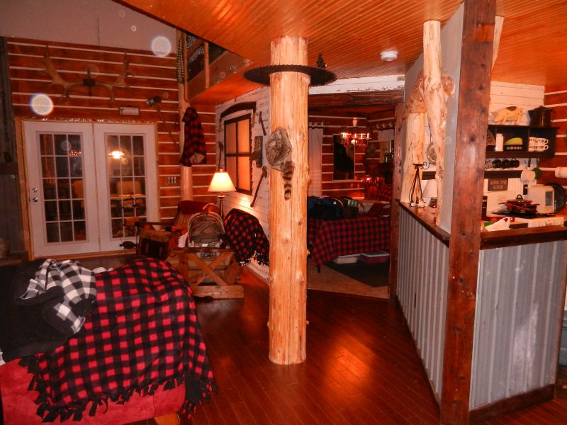

I guess my situation is somewhat different from yours. My cabin is approximately 14x22. It is a vaulted ceiling with a loft. The loft covers a little less than half the area. The remaining area is open to the vaulted ceiling similar to your place. The half of the floor space that is covered by the loft is where we have our dining table and kitchen area and the loft acts as a ceiling in that area. A lot of heat from the woodstove and the cooking area does get trapped and sits under that ceiling. My back room was initially a screened in room and not part of the cottage living area. I closed that room in and made it my bathroom area with an old clawfoot tub/shower and vanity on one side and my propane fridge and a pantry is on the other side of the room. Although I insulated it well, we found that the heat from the wood stove at the front of the cottage did not make it to the back room and when it was very cold out, that room remained very cold and the cold could be felt as a draft through the doorway when we sat around the table making the main room feel uncomfortable. Where I cut my vent hole on the back wall, it was close to the ceiling over the kitchen area where that hot air accumulated. The heatstick on the opposite wall helps to draw that heat through that vent hole into that room. I guess I did not mention this prior and I do apologize, I did place two heat sticks in that room. One only to the height of the ceiling in the back room to help draw heat through the vent opening and the other through the ceiling of the back room to the peak of the vaulted ceiling upstairs. This does draw warmer air down into that room from the loft as well. The majority of the warm air is through that vent hole though.
This is a long winded response and I apologize for that, just trying to explain my set up and why it seems to work for me. I guess a picture is worth a thousand words and I will try to find some over the weekend and post them.
To answer your question, your heat is going straight up to the vaulted ceiling, bypassing your room. A vent hole in the wall would draw some warm air into the room, but I suspect I am having good results because of the ceiling area trapping the warm air at the height of the vent opening.
I do feel, based on my results, that a heatstick along the inside wall of your room, (wall closest to the open area), through the ceiling, to the peak of the loft will help draw heat into your bedroom area.
Another suggestion may be to cut a vent opening in your bedroom wall and wire a 3" computer fan inside that opening to draw heat into the room. Of course I do not know what your setup is as far as 12 volt power etc and how easy that would be for you.
Again I am no expert at all, just found it worked well for me and if I can share my experience to help you then all the better.
I have attached 2 pics that I found on my blackberry, I know the quality isn't the greatest. The one shows the wood stove and the other shows the back wall with the ceiling. When I closed in the back room, the door that can be seen in the picture was removed and left as an open doorway. Again when I get home I will try and find some pictures I took of the heatsticks installed. Hope this helps.
wood stove in front part
loft over kitchen area

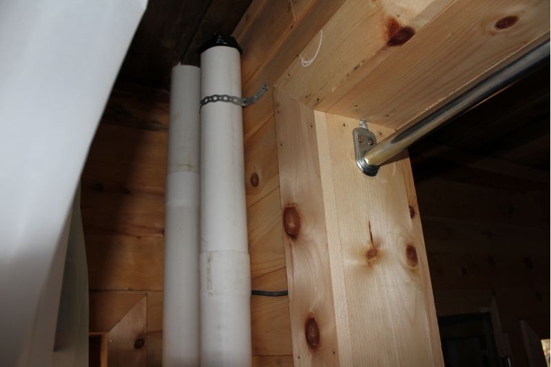

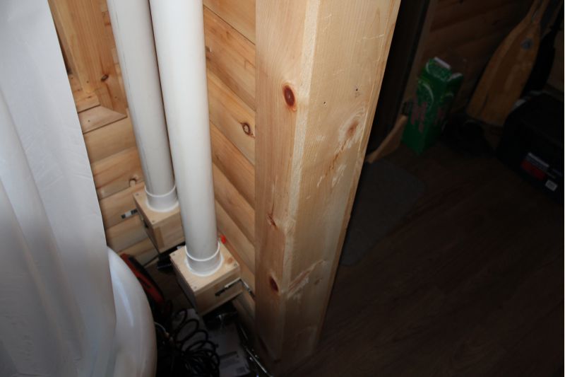

# Posted: 23 Feb 2013 05:28pm

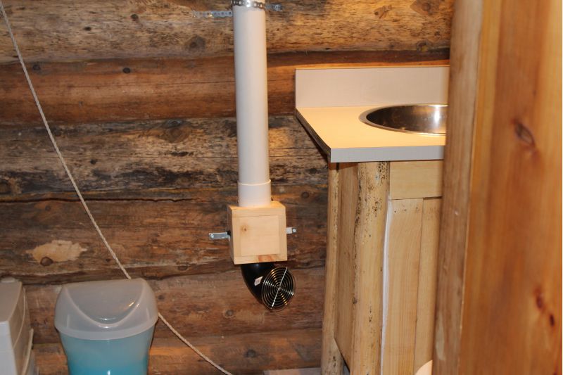

I like your idea of the fans and a vent cover on each side. I think that will help warm your bedroom a lot. Here are a couple more pictures I found.
I love having the Canadian flag flying out there! I always say Americans are way more patriotic thanus Canadians and we need to do more to show our patriotism!
in bathroom
in bathroom
one to ceiling, one through to peak
skootamattaschmidty
# Posted: 23 Feb 2013 05:38pm
Oops. attached two of the same photo. Here is the other. I guess I dont have pic of the hole I cut in the back wall.
One through ceiling
One through ceiling
