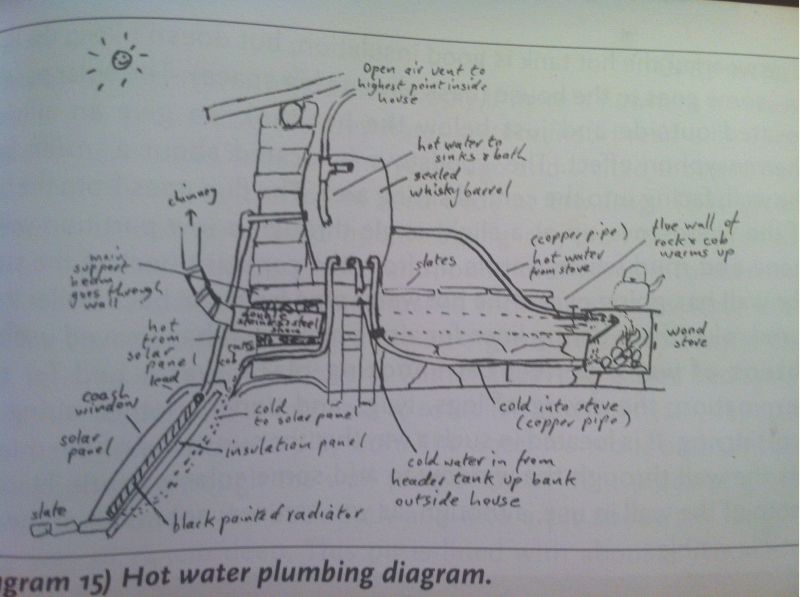

for hot water, there is a cool little system that I would like to try once I build my cabin. Basically, it's a thermosiphoning system that uses solar in summer and woodstove in winter. So, you get an old water heated radiator and paint in black and build a glass fronted box for it. Plumb in cold water at the bottom and plumb the top exit out to your elevated holding tank. Same with the wood stove. Plumb in an element that lets cold water in the bottom and pushes the hot out the top of the element into a holding tank. That way when it's sunny, in summer you are producing solar hot water and in the winter, hot water from the woodstove. Can upload a diagram from a wee book I've got if you want to see it. probably a simple thermosiphoning system may work with your idea with the 5 gallon container on the furnace too.

# Posted: 30 Jan 2013 06:42pm
solar and woodstove hot water system.
