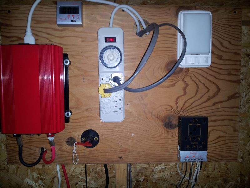

I've been using seven Marine batteries for eight years (primarily weekends) at our cabin. Most of the energy goes to a composting toilet fan, tv, lights etc. I haven't had any problems. Are deep cell batteries really better? I know they have heavier plates and can be charged and discharged more often. I just wonder if anyone has done a true cost comparison...more deep cell batteries vs. fewer marine batteries over time. Charge controller and Inverter
