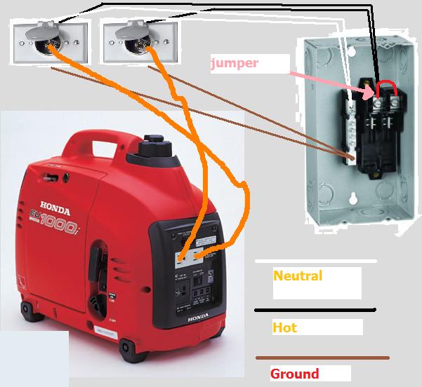

 I'm wondering if I'm capable of running 2 'power inlets' into one 'load center/breaker box' -- I've put together a simple illustration of what i have, and I'm not looking for AHJs and all of the specific codes regarding my question.  I'm more curious to know if this is capable of being done.
 1) Can i use 2 power inlets to power a single load center? (I want to know if i can use 2 extension cords from my generator receptacle to plug into 2 power inlets on my cabin, and then have both power inlets terminate in the same load center)
 **I assume this cannot be done but figured I would ask because I have 2 power inlets sitting around

 Looking at your drawing, you can do this- but I have no idea why you would want or need to.  What's the beneift?  Although there are two outlets they are both on the same circuit inside the generator.  So, you will get the same amount of power to your load center with just the one cord.  And with only 1000w, it's not like you'll exceed the ability for a standard 14g wire to handle the draw, so you don't need the excess carrying capacity of 2-cords in parallel.  Why complicate things?

 Thats exactly what i needed to hear. I didnt even think about the output of the generator being the same regardless. Thanks for the response.

 One other question.  I know you're not supposed to bond the neutral and ground more than once in any electrical system.  Assuming my generator has the neutral and ground bonded, how do i go about wiring the neutral and ground into the load center which only has one ground bar/neutral bar?

 | # Posted: 4 Feb 2013 01:45pm - Edited by: rayyy Reply
