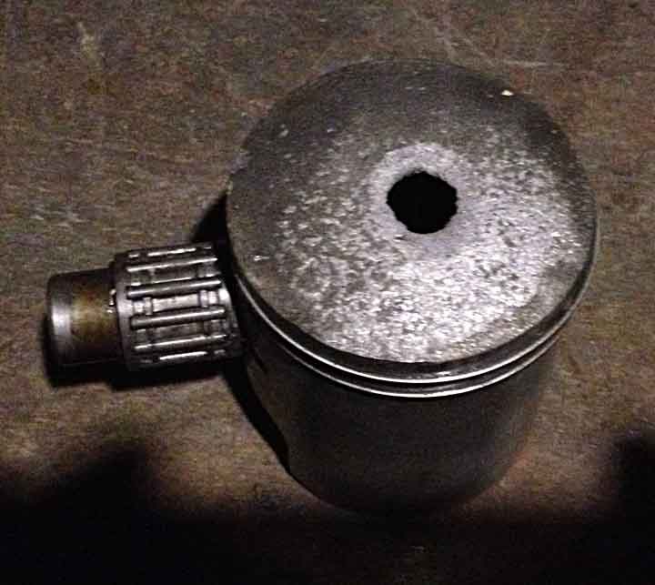

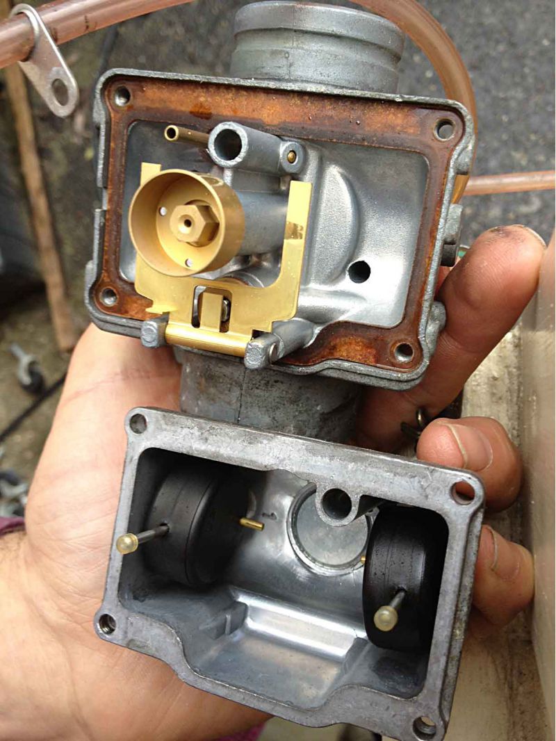

 Quoting: littlesalmon4 It only takes 1 jet to be plugged and you are out the top end of your engine.
 Well as I write this I am holding a bunch of replacement parts..... oooops.  I don't attribute this to the gas,  I think it was the base gasket.
 The sled started easily after sitting the whole year, and ran great for 3 weekends prior to the holy event.  I can tell this carb has never been removed since 1998 and it's clean as a whistle.  Maybe the previous owner kept it dosed with Sta-bil??   But I have not in the 3 years I've had it.  There are a lot of bad words about ethanol lately, I just assume it's cuz the oil companies are charging you more for what costs them less, and they want you to focus on something else.  Hard to say.

 Tomchum. The main jet is the small hex nut in the middle of the carb, there is another jet under the flat brass clip. The needle jet is attached to the top carb nut. There is also a pilot jet the you remove from the outside of the card. These jets have tiny holes in them. Make sure they are all soaked and cleaned before re-assembly.
 That piston looks like detonation to me. It is from running to lean of oil mix. A plugged or slightly plugged jet will cause this. This is exactly what i meant when i said cleaning carbs is cheap insurance.
 This is what your jets do.
 pilot jet looks after idle to 1/4 throttle
 needle jet looks after 1/4 to 3/4 throttle and the main looks after 3/4 to full throttle.

 is that a artic cat? if you find no fault with the carb you may wanto to check the crank shaft seal on the side in which the burn down happened. also make sure there are no exhaust leaks.

 Both pilot and main were clean (as a whistle).  Nothing in the float needle either.  Nothing.  Clean as new.
 Yes its either lean - or a hot plug - or detonation due to carbon buildup or burning ember - or the base gasket - (or the crank seal, thx larry I forgot).  It's an AC Jag340, with oil injection.
 The base gasket came apart in pieces - NOT stuck to either part, and there was drool all around where the base gasket should have sealed.  Not even sure ll the pieces were there.  I think this was caused by the base gasket.  All studs were tight.
 I will be checking every orifice, but in 40 years I have never seen such a clean carb.  I'm especially suprised on a unit that has gotten absolutely zero maintenance attention from me except when it quit.  You know in the past we used to put alcohol in the gas to absorb and burn the water (rather than draining the tank).  I wonder if alcohol always in the gas allows the gas to accept more water.  Whereas if no alcohol, a water glob just plugs the main and it cuts out.

 If your base gasket or crank seals are leaking, you're sucking in pure air and less fuel. This will cause extreme high temperature on the piston top. No two stroke will last with any crankcase leaks.
 Ethanol increases the volume of fuel by adding oxygen to the fuel. That is just about the same as a leak in the crank case. Ethanol use can be adjusted for with larger jets, more fuel.
