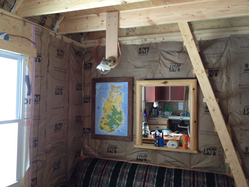

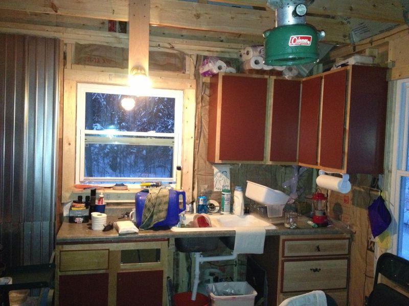

I just installed two used propane lights in my cabin over the weekend. Both are connected to a single 20lb tank. One works great (and is closest to the tank) and one sputters a bit. The one that sputters is about 16 feet away from the tank and its wick has a nickel size hole in the bottom. Any ideas on why it would sputter. Is it as simple as replacing the wick, or might it have something to do with the distance from the tank? something else? I was able to get it to work at one point when the one closest to the tank was turned off. The copper tubing connecting it all is 5/16". tcmatt the good one
|  the "sputterer"

i just realized that the coil of copper tubing in the back ground looks like it is connected to the light. It is not. It's just the left over hanging on a nail on the wall.
