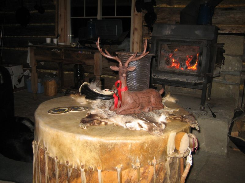

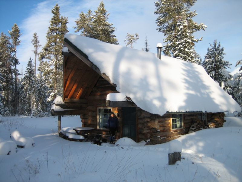

I bought an old wood stove for about $200 with all the pipe including tripple wall to go through the roof. It has a screen to attach to open the doors and use it like a fireplace. We maintain about 70 degrees in out 14 x 24 log cabin even when it is well below freezing outside. We also cook off the stove with an array of dutch ovens and cast iron skillets. winter pic
|  wood stove
|  wood stove

elkdiebymybow your place is glorious.love all the pictures.
