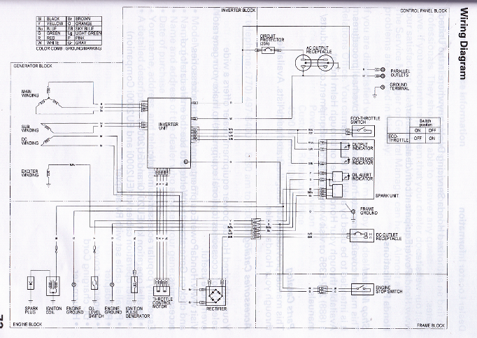

 I am going to use two Honda 2000i generators in parallel for our off grid cabin. Question 1: Are the Honda 2000i bonded? Question 2: in the cabin at the breaker box to bond it, all I need to do is screw in the green screw? I know you can only one bond in the system and at the breaker box would be the better of the two. In the wiring of the Honda wiring is it bonded?
 Honda 2000i wiring:

 Quoting: buckeyebuck In the wiring of the Honda wiring is it bonded?
 I see the inverter is grounded to the frame of the chassis, You are going to need to use an ohmmeter to determine if there is a bond in the inverter

 Can't tell from your drawing whether the generators are bonded, but they should be. Bonding at the subpanel is not the best idea, but then at least you know you have the bond. I looked through the manual for my Briggs and Stratton gen set and they made it clear in the manual that neutral and ground are bonded in the generator itself. Have you read the manual carefully?

 I called Honda and they  said the 2000 was not bonded but will go through my manual again and see if I can find anything on bonding. Thanks for the info

 The Honda is fully insulated by design, no bonding is needed. Bond at the panel.
