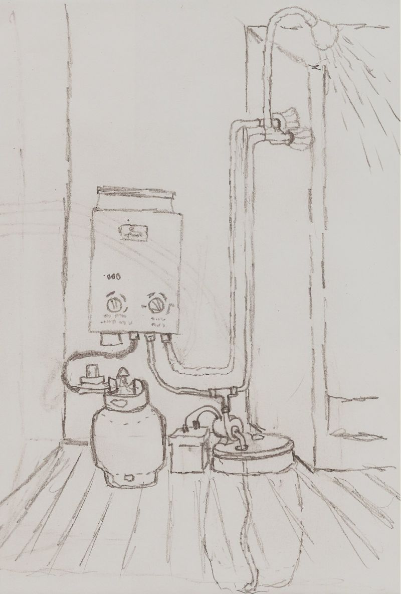

Here is a sketch of my lay out for hot water.20 pound gas grill propane tank feeds my Eccotemp L-5 hot water heater.Pump is a 12 volt rv pump with a built in pressure switch.The water is nice and warm in 3 seconds.The size of the water tank can be anything from a 5 gallon bucket to a 1000 gallon tank.

Rayyy, Very helpful drawing. If used inside, do you just open a window for ventilation? Thanks!

Yes,assure your self of plenty of fresh air coming into your place near the heater while your using it.I have a carbinemonoxide detector in there just to play it safe.I use mine every morning.I take a quick shower due to the fact of limited water supply.Keep in mind,this is the basic design for hot water supply.The gas tank is actually out side the cabin.Those 12 volt pumps can pull water up some 10 feet in elevation,so having your tank of water a little lower than than the pump is ok.I also must admit,in the dead of winter when that water is in the 30's,F it's hard to get it up to comfortable temp for showering.I have to throttle down the flow almost to the lowest flow for the heater to function but it does work. Iv'e been very pleased with this set up.I also recomend you put a filter on your down spout going into your water storage tank.It's much easier filtering out the crud befor it get's in your tank.Also clorinate the water befor using it.I'm blessed to have a creek that runs year around on my property so I don't have to mess with rain water collection.But if that's your only supply,you got no choice.
