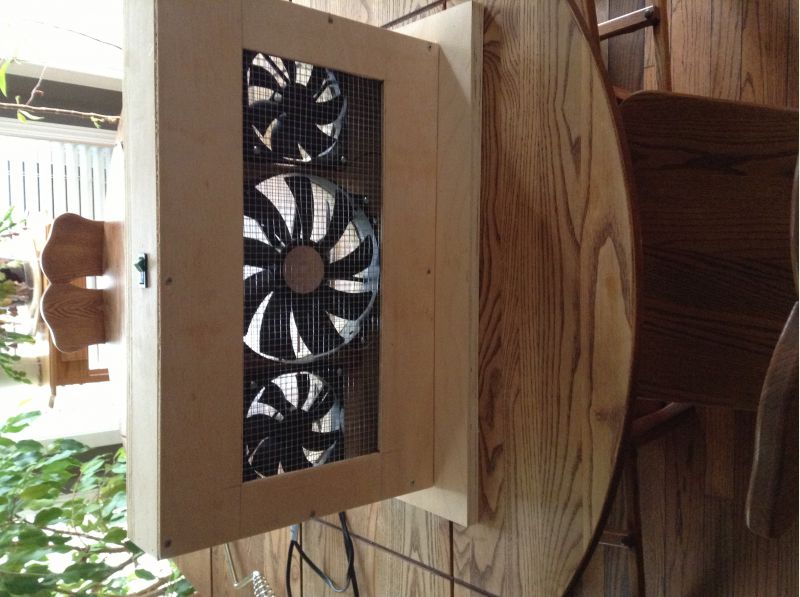

I just thought I would share a recent project I put together to get ready for those hot summer nights. If they ever get here this year!
I am off grid at my cabin and I wanted a way to move some air in my loft during the night when we are trying to sleep and it is hot and humid.

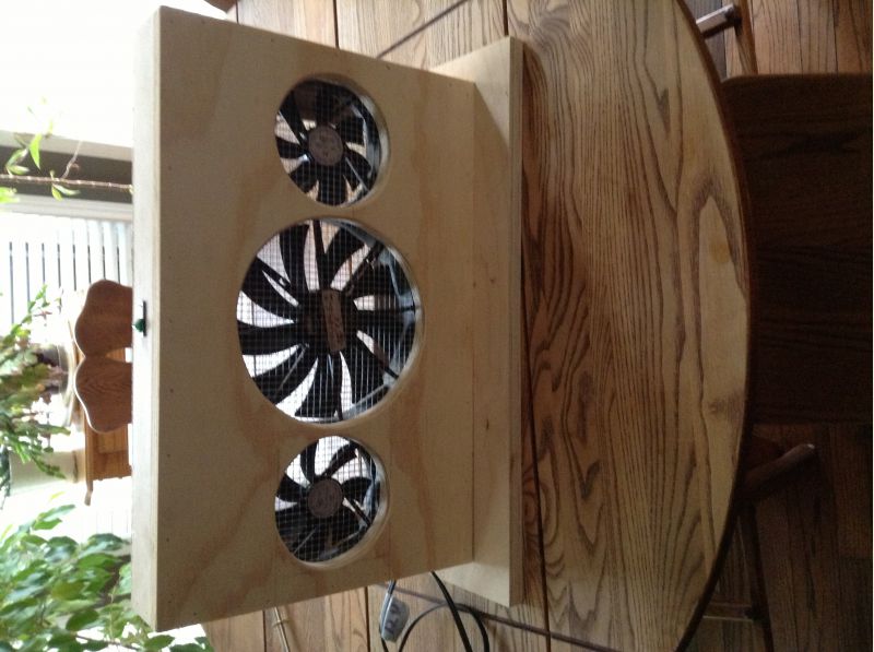

I had some computer fans at home so I put together a unit with 3 fans in it. There are two four inch fans and one eight inch fan. The fans are easily found at any computer store for very little money. They are 12 volt and in total they draw less than an amp of power and put out 250 cfm's. I wired in a switch and a cord that will plug into a receptacle I have wired for 12 volts. The box is plywood and the fan covers are 1/2" square wire netting found at TSC. It makes quite the breeze so I am looking forward to using it this summer. I call it my redneck air conditioner.
12v fan
12v fan
Fan from back
Fan from back

That is really cool! Had you though of putting it on hinges to be able to swing it back to the wall when not in use? I think I might steal your idea if you don't mind.

I didn't think of hinges but that is a cool idea. I guess I was thinking of it as being portable so I can move it around if I want to. Feel free to steal the idea! That's why I thought I'd post it here!
