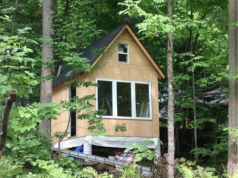

I am happy to say that my little cabin made it through the Canadian winter safe and sound. No trees down on it and it didn't seem to shift very much. Thanks to everyone here for all of the help (still a lot of work to do .
My next question is that I am looking into investing in a generator to run some lights and a laptop etc.. I was looking at purchasing this generator:
http://www.homedepot.ca/product/2200w-inverter-generator/827630
My question is that I would like to know if anyone has experience running something like this (it is rated at 65 db) near neighbours? I really don't want to be a bad neighbour and have noise going on numerous hours of the day. I am really not sure how loud 65 dbs is and I can't try it out without buying it.
My neighbours are 100 feet away on both sides, but my real problem is that the cabin is in a valley and sound carries. I keep thinking though that seadoos spend hours blasting away in front of our shoreline every so often. I am hoping it would just be a very low droning and wouldn't bother anyone?

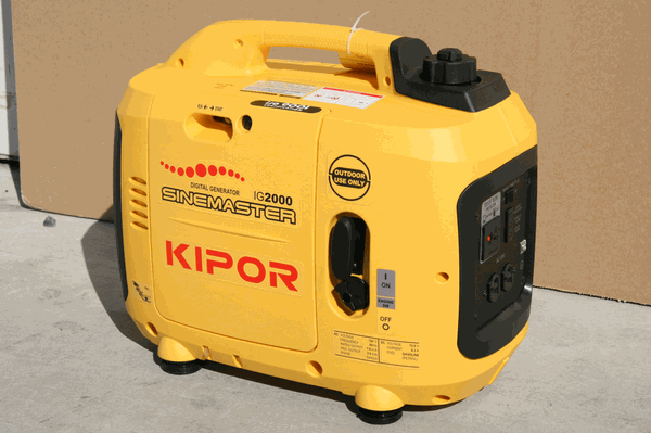

I have found Kipor brand to appear really close to the Honda in appearance. Price is less, look around the internet. Maybe if they ship to Canada, our Canadians brothers can get a good price on one too.
Here is just one site. I didnt scour the web for the best price. Amazon seems to be where I find the best prices on anything.
The model is the IG2000, it is a sine wave one also.
