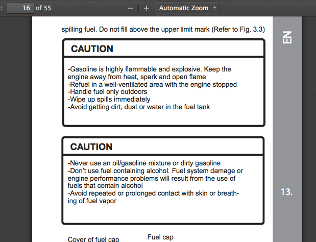

 Not sure how much this matters....the manual says no fuels containing alcohol can be used?  Many places sell 10% these days.
 EDIT: Their web site says up to 10% ethanol is ok....probably not the issue.
