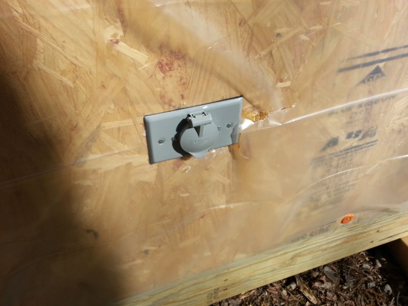

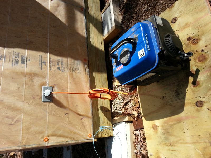

It seems you're just looking to have a few simple outlets not intended for any major appliances. I set my cabin up the same way.
You can use an "inlet receptacle" like the one I linked below, and wire it directly to your outlets. This method is very simple and not "code," but it seems you just want a few outlets with power on the inside for various reasons. This inlet box is weatherproof and allows for you to use a regular extension cord connected directly from the generator without the risk of frying yourself.
http://www.amazon.com/gp/product/B00074USHY/ref=oh_details_o02_s00_i00?ie=UTF8&psc=1  20130315_161439.jpg

Thank you! This is exactly what I was looking for. Out of curiosity, are you grounding your generator?
