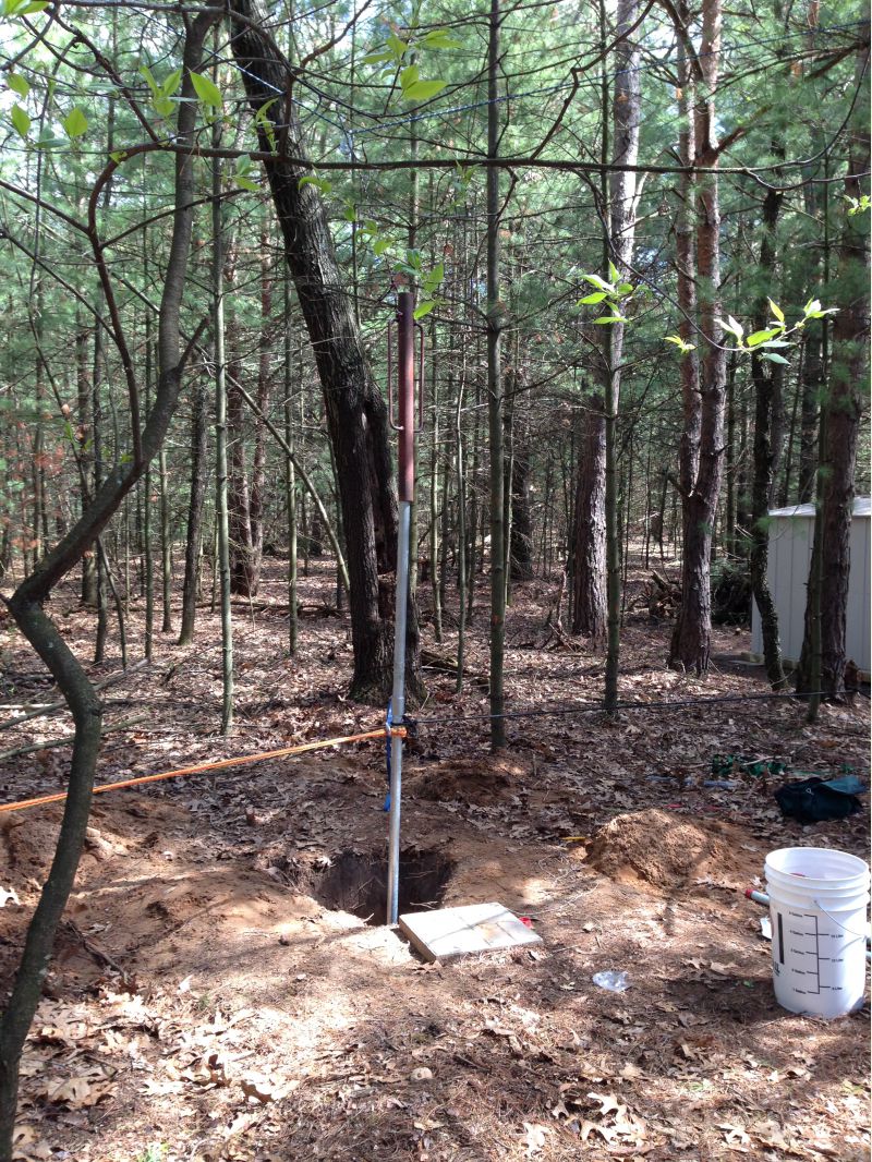

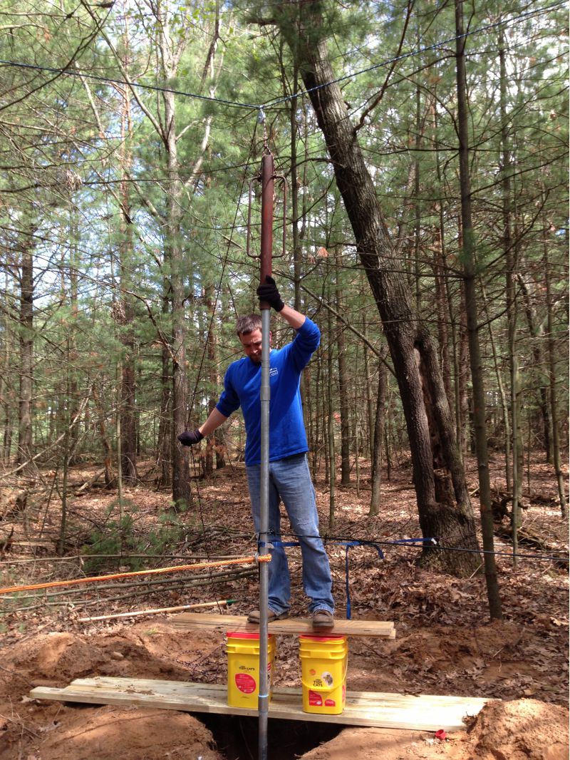

At this point I have a three way tie on the pipe securing it while I drive with a post hole driver on a 3.5' sacrificial pipe. My drive cap will not fit under any post hold driver I have found and a sledge hammer is not the way to go. Every time the pipe mushrooms over I hacksaw the end off.
