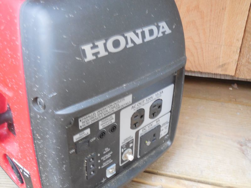

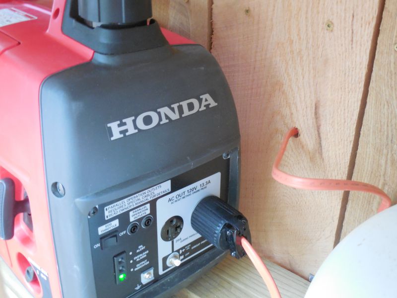

OK, here is my set up:
I have the house panel box wired to run the house through one 30 amp plug on the Honda Companion unit...see picture 1.
I have the second Honda (the one with the 2 regular 110 plug-ins) that I hook up in parallel when we need extra power (AC, etc.)...see picture 2.
What I am looking for is a way to use the second one to power the entire house as the one in picture 1 does.
As it is now, the Honda with the 2 110 plug ins gets used very little at all. The one with the 30 amp plug gets used ALOT. What happens if the Honda with the 30 amp plug goes down?
Just trying to be ready for the what ifs.
Honda Companion Unit Wired to Run House Through Panel Box
Honda Unit with No 30 Amp Plug In
My Set Up
My Set Up

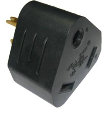

# Posted: 5 May 2013 16:42
Gotcha. Easiest solution around. Go to an RV place,t hey sell the adapters to convert your 30A to fit in your std household plug. So when running a single generator where amperage wont exceed the 15 amps, you can run it on either, but if you parallel the gennies together, then remove it and plug it into the parallel kit plug.
Here it is:
http://www.amazon.com/Conntek-Male-Female-Connector-Adapter/dp/B001TO4WCS/ref=sr_1_4? ie=UTF8&qid=1367786430&sr=8-4&keywords=RV+cord+adaptor
Picture:
Duplex to RV plug adapter.
MJW
# Posted: 5 May 2013 18:08
Awesome!
This is actually the one I need.
http://www.amazon.com/Conntek-Locking-Adapter-Female-Connector/dp/B002YB108Y
Some expensive little boogers...
# Posted: 5 May 2013 22:58
Quoting: MJW
Awesome!
Ok, for soem reason, I was thinking that companion plug was one of those 30A RV plugs and not the 30A 120VAC twistlock.
But either way, problem solved.
