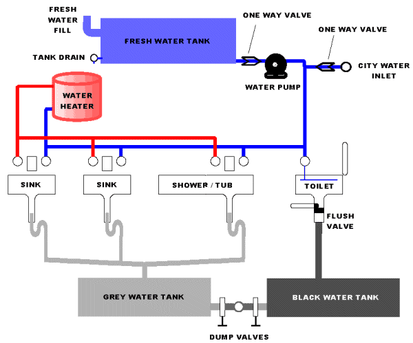

I'm sure this has been covered but the search would not hold "RV" (too small). Our cabin has a creek running by it that we can tap into for water. The thought was to put a system in the cabin like an RV would have,...but I don't know what all components (heater, valves, traps, pumps etc.) are involved. Can someone educate me? The reason I'm looking at an RV type is that I *think* it's simplified and can be winterized with antifreeze fairly easily. Luckily, our landscape is very steep and I'm sure I can get pressure from water that runs and pools above the cabin. I'm trying to run a stand up shower and sink. I will have electricity to the cabin also. Thoughts?? Pictures or links would be great too!

0.43 psi per foot of elevation of the water pool/tank supply. you will likely want a pump like an RV uses. 20 psi is more or less the minimum for supply pressure.
RV's will have a water supply tank, a pump, a water heater and the sink and shower. toilet. Google RV water heater and RV water pump. Heaters are Sunburban or Atwood and pumps are Shurflo and Flojet for the big names.

If you are going to have grid electricity, it would be better and cheaper to use a 110 volt shallow well jet pump system and a wall mounted 110 heater. That way you will not need a 12 volt power supply in the cabin, RV stuff is all 12 volt. You will also have higher pressure and more volume . not that a 12 volt system will not work..! have one and it works great , but if I had a 110 source I would go with that ..

# Posted: 21 May 2013 10:57am
here's one ,that might help;
