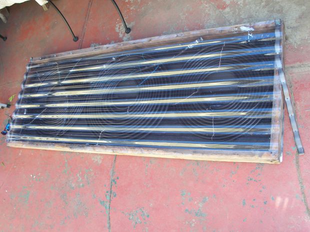

I'm starting to plan out a solar hot water set-up for my family's off the grid cabin in central Maine. The current setup is a wood stove that heats water in a large upright tank through convection. This works so-so, the stove has to run for at least an hour before there is any hot water. None of my family really minds this wait but I thought it would be cool to try a simple solar setup in addition to the stove heating the water. Here is my plan, please let me know what you think:
Build a simple box with coiled black plastic pipe such as shown below in the photo. I will then run a line from the coiled pipe to the hot water tank. To move the water I plan on using this small pump:

1.Black plastic pipe will melt /leak when hot,it's NOT designed to carry HOT water 2. that pump is a "circulator.for a closed loop system.NOT a true pressure pump.buy one that will pump(pressure) Harbor freight--39.99-49.99 that produces pressure and some sort of Volume of water. Yes they have 12 Vdc pumps that will run off a battery. 3.that solar panel (probably) WON"T run the pump (my 2 cents)it would have to be faced directly to the sun to produce 5 watts (IF) your lucky- 4.Solarblvd.com has 20 watt panels for 29.99/ I bought (3). but i use them to keep vehicle battery's charged.

Hmmm.. I've seen a bunch of set-ups online with black plastic pipe, I wonder what their experience has been. I could get around that using PEX tubing and spray painting it with a high heat black paint.
I don't need a pressure pump. The water system at my cabin is gravity fed. So the pump would only need to very slowly circulate the water from the PEX through the hot water tank. Would this pump work in this situation?

also builditsolar.com has a lot of great info on solar hot water set ups. from what I've seen heard, not having built one myself yet, is keep it simple. forget the pump, use convection, the same as your stove heater.
