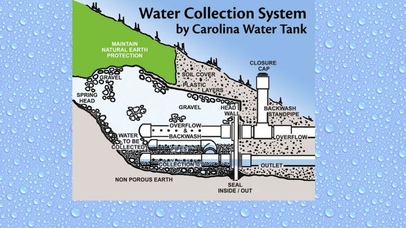

Martian
# Posted: 4 Jun 2013 08:03am
Frank, think about a "spring box". It is nothing more than a hole in the ground in which the water collects.
Settlers around here dug a hole, surrounded it with stones to hold back the dirt, and put in a pipe to drain the accumulated water into a cistern. A cover, to keep out critter, leaves, etc., was put over it.
If you dig a well, you may disrupt the spring.
