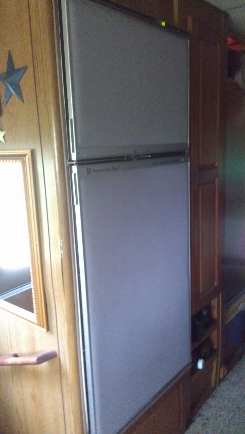

Thanks for the info, MJW. I didn't realize a generator would run that long on so little gas, not bad. That will be a must for us to have for extended cloudy periods. You have quite a system there! We will have a far smaller system to work with but have learned to live with minimal power usage already so I'm sure will be fine. I'm not certain just what we'll do fridge wise but most likely will stick with our propane as it is good sized and really meets our needs. our Dometic Royale propane fridge
# Posted: 28 Jun 2013 09:34am
I got tired of hauling propane ... and the cost. So I bought a 10 cu ft fridge/freezer with a rating of 312/yr. I have a 1 kw solar system with 1200 amp hrs of battery reserve (@12v). This system works admirably as long as the sun is shining. So far (2 months?) I've run the generator for an hour or two twice to give my batteries a bit of a bulk charge assist. It'll be a different story come nov/dec, but for now it's all good. Highly recommended. For a fridge I would recommend a 24v system with 800 amp hr capacity (1600@12v). 1 kw of panels should still be adequate. But what the heck. Another 500 watts would be useful to run a small air conditioner in the late afternoon.
