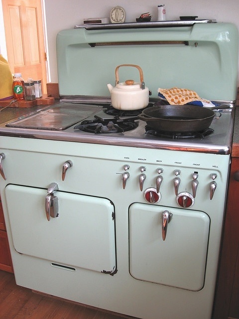

This is what I really wanted and it would have been amazing in my cabin. However not up to code.
We didn't choose to be off grid either. The nearest power lines are about 1 1/2 miles from our cabin. It would cost about $100,000!!! to run electric to the cabin.

Silverwaterlady, that stove in your picture looks like a combo wood-propane unit. I have one in or old camp and it also works great. When you are off-grid it doesn't matter about code. You can't get insurance anyway.
# Posted: 24 Jun 2013 08:40pm - Edited by: silverwaterlady
Hmmm-I have insurance on our off grid cabin since it was built in 2006 and that is without an address and it is log. I pay a high premium but I also have a cabin that would be very expensive to replace.
The stove is a Chambers stove. It is gas. The cool thing about it are the fire bricks inside. That makes it very heavy about 400 lbs. It also makes it super insulated. Everything cooks with half the amount of fuel because one can turn the oven off mid way through baking,the fire bricks retain the heat.
