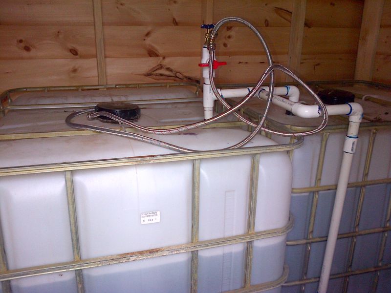

 I have attached a picture of the shed we have them in. It is very dark in there when the doors are closed (99% of the time) but it is not absolute black.
 We are very happy with this set up but I just want to make sure I am being safe with it.

 Been using our tanks for over 2 years now adding a 1/4 cup of Clorox to each tank every 3 or 4 fill ups (about once a month)
 So far they are still clean as new...no algae. When the tanks are filled the water still looks a pale blue like a photo taken on a Caribbean beach.
