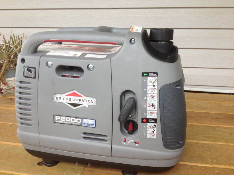

# Posted: 2 Aug 2013 01:37pm
Just bought a small craftsman from sears comparable to the Honda but cheaper. nice and quiet.
http://www.sears.com/briggs-stratton-1600-watt-powerstart-series-8482-inverter-genera tor/p-07133148000P?prdNo=5&blockNo=5&blockType=G5
Rossman
# Posted: 2 Aug 2013 11:26pm
Wow, it looks like they just copied the Honda!
# Posted: 4 Aug 2013 12:52am
Quoting: Rossman Wow, it looks like they just copied the Honda!
Imitation is the best form of flattery.
