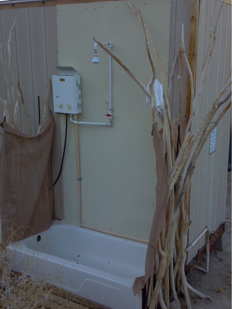

# Posted: 20 Oct 2013 20:19
I'm writing again to laud the Ecotemp! Last spring, my outdoor shower that we have used for 4 years stopped working...I tried switching tanks, hoses, blowing out the inside with air, new batteries... no luck. Well I just figured that after 4 years of hard use, plus the fact that I really don't take very good care of it (leaving it out in the desert sun) it was just time for a new one. We had just built a new indoor shower so the outdoor one and not been tried this season yet, until some friends came to visit, they got up early one morning and took their showers and came out raving about the awesome outdoor shower experience... I said, weren't you cold? they said, no it was nice and warm. So I tried it out and it has fixed itself! I must say that in spite of the nice new indoor shower, I really prefer the out one.....
