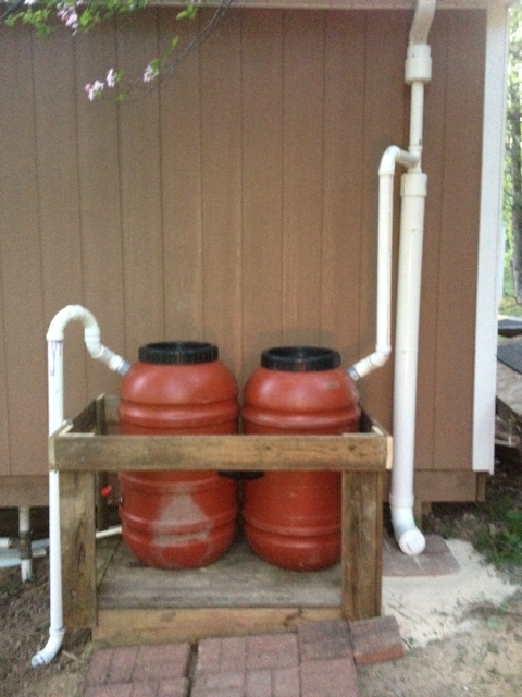

 That will work.  I recently built a system for mine using 4 in pvc pipe that serves the same purpose.  Mine works great! Maybe try a rubber street hockey ball if you are worrying about the tennis ball falling apart.

 Great suggestion on the street hockey ball. Was looking in the toy store at plastic balls, but almost all of them were not sealed completely.  Will hit up the sporting goods store today.

 Hockey ball works great on my first flush system.

 mjmmessina. can I ask you how you joined your barrels together. I've tried a couple of methods with limited success. eventually (minutes/hours/two years) the joints begin to leak.

 hey just. the brown / clay coloured tanks that mjmmessina is using appear to be from an olive importer. they don't have threaded holes. You have to cut holes in them and then silicone/cement. i'ma hopin' that someone has a good connector trick. I still have 3. Got a bunch for 15/each. oh those many years ago.

 They were olive barrels.  Took me a while to get the olive smell out of them but  The spin off lids are nice  incase you want to treat the water with anything.  I used a kit purchased online with a flex hose and gaskets that are self sealing.  Has worked good so far.  I thought about hard plumbing them together with 2" pvc male / female fittings bud they would be hard to disconnect for winter months.  This kit makes it easy to remove

 thx mjmmessina. wish I'd had those for my last setup. I had three barrels put together with a special cement and they lasted exactly the amount of time it took me to stand them up after assembling.
 that linking kit looks like just the ticket.

 Creeky, It has worked great so far.  I'm sure in a few years the gaskets may need replaced but they are inexpensive and the flex lines makes it real easy to connect.
