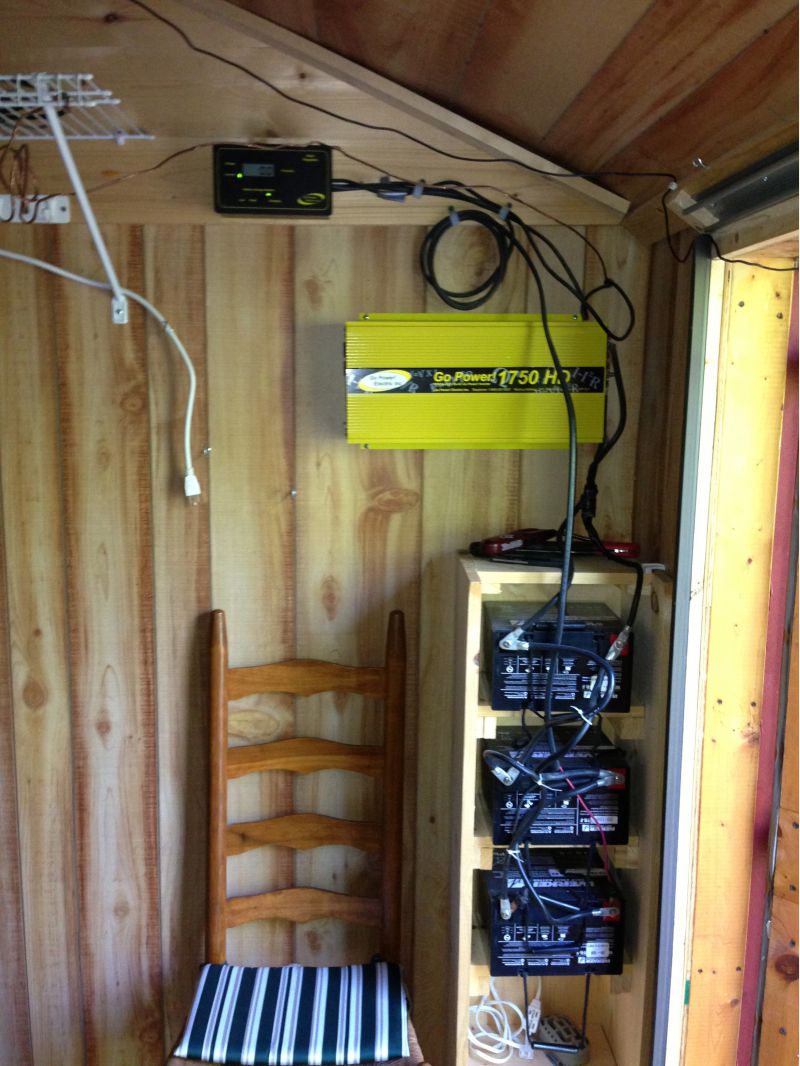

Hi all. New member here. About a year ago I purchased a cabin on 15 acres in southwest VA near the New River. Wonderful piece of land that has 2 small cabins and a shed. We are really enjoying our time up there. I wanted to get your take on the solar setup that was in place when we purchased the cabin. It seems to work fine - but wanted to see what other think since this was installed by the previous owner. I could not find any information on what the actual panel is. Also curious about what chances I have to expand as well as what benefit would there be to adding 2 more batteries to the series (i have two more cubbies for batteries if I wanted to use them).
Inverter: Go Electric Heavy Duty 1750w modified sine wave
Go Electric Regulator
3 - 12V 55AH deep cycle batteries in a series
Panel - unknown (any way to find out?)
My other question was the current set up for using the power is through a series of power strips plugged into the Inverter and then around the cabin (cabin is maybe 150 sqft). Does this diminish the power and performance? Is there a better method that is simple to install?

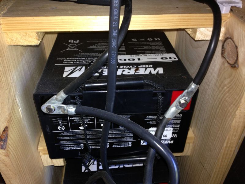

judging from your pictures, your batteries are actually parallel wired, and in a manner that does not allow them to discharge evenly. They should be wired as shown in the lower left here for more even draw battery schematic
That being said, you usually don't want to add new batteries to old, it essentially pulls the new batteries down to the age of the old.

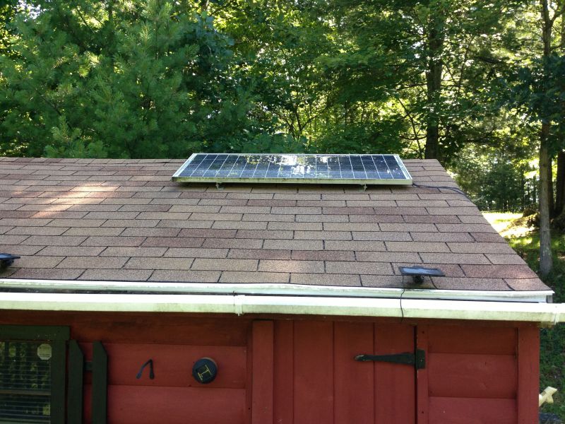

The panel looks like a decent sized panel, if you want to know what it is, you'll have to look under it, there will be a sticker on the back with it's specifications.
It looks to me from a glance that you are a little under-paneled for your battery bank, but without knowing the specs on the panel, or what charge controller it's hooked up to, I'm just guessing. (I can't tell what charge controller from the picture). You have a 165 ah, 12V bank which looks to be made of sealed type batteries. A charge rate around 15-18 amps would keep them happier.
The inverter is very large in comparison to the size of the battery bank. If you ran it anywhere near full load, it would flatten the battery bank in no time. If you aren't going to run large loads from it, I would recommend a smaller inverter which will draw less when not being used.

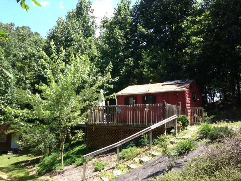

Great looking cabin!

I think most batteries are designed to stand upright, yours appear to be on the side. You should check on your battery type if side position is acceptable.

First thing I see is the batteries are in your living space, personally I would enclose or isolate them and also vent to the outside for needed air circulation ie, fumes and heat from inverter etc.
I also see carry handles on the batteries that would indicate they should be in the upright position,now go buy a KillaWatt power meter to see how much power you really need by checking each appliance power consumption, all in all I like the place especially the half round siding!

they look like AGM/sealed type batteries to me. I don't see removable caps on them which would indicate so.

Based on the physical size of the panel, it appears to have a decent wattage (100W), but I disagree that you are "underpaneled" - it's probably just right. But, as stated, you'll have to look at the bottom of the panel for the specs, and same with the charge controller, and get specs for us amateurs to give you more info.
Coffee makers are notorious for drawing a lot of power for what they do. I don't know where Steve961 got his info, but Go Power!'s website shows the inverter is rated for 1,750W continuous, but only 2,150W surge, so I bet the surge of the coffee maker when you turn it on is exceeding the inverter's surge limit and that's why the maker won't turn on. I'd just go to Goodwill and buy a maker that draws +/- 900W and you might just be in bidness.

in my "studio" i ran armoured cable and surface mount boxes. Safer for sure. on the safety note, you might want to put a cover over the batteries. unless you don't have pets or kids or ...

nice looking spot.

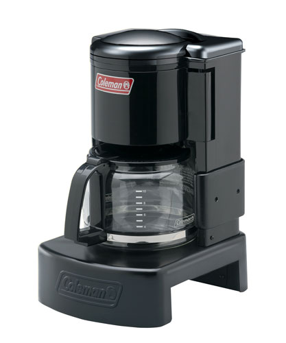

Coleman makes a drip coffee maker designed for cooktops.
a 100W panel will have a charge rate in best of conditions around 6 amps. Into a 165ah bank that is a 3.6% rate of charge...that's awfully low and probably won't keep that bank very happy. If it's a 200W+ panel hooked into an MPPT charge controller, that would be much better.

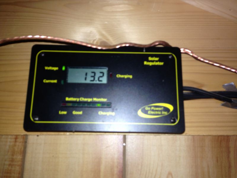

Here is a picture of the charge controller.

With that charge controller, and your battery bank, you can easily ,and cost effectively, improve the performance of your system. Dillio is right in that you are underpaneled if you only have a 100 watt panel attached. Conventional wisdom is that you should have anywhere from 5-13% of the battery bank in panels. That would be 8-21 amps (i.e. ~135-352 watts) of panels. Your charge controller should easily be able to handle that.
I would recommend adding just one more 12 volt panel as two panels wired in parallel does not require any special fusing. Also try to buy as large of a panel as you can since the price per watt decreases dramatically as you go up in size.

richmondgolf, you are not underpaneled at 100W just because it is 100W. It all depends on the frequency and duration of use of your applicances. If you are using only a few small appliances occasionally during occasional visits, don't waste your money buying another +$200 panel and $100+ charge controller just because of some 5%-13% "rule of thumb". Your existing battery bank and charging rate will be fine. If your load on the bank is significantly greater, then, yes, you will have to consider upgrading.
I am a big proponent of cost-benefit analysis, which here begs the question "is the cost of buying a new panel and charge controller worth the marginal benefit when power usage is low?". And I like to debate sometimes.
