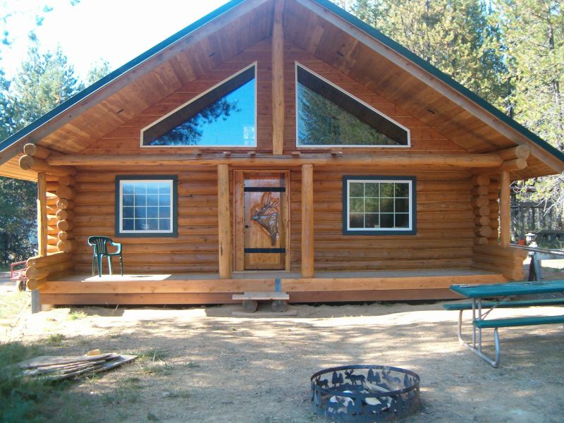

I built a small log cabin in north idaho and it has a creek on the property. Is anybody using creek water if so what kind of filter system are you using. Right now i have a 700 gallon poly tank buried and use a rv on demand pump to pump into cabin. I have bought a 2 filter system with ultra violet light that will kill bacteria but have not installed it yet. the filters are 1 micron and the other is .5 micron. I think they will plug pretty fast,anybody have any experience with this they want to share. Im currently hauling water and hate doing it.

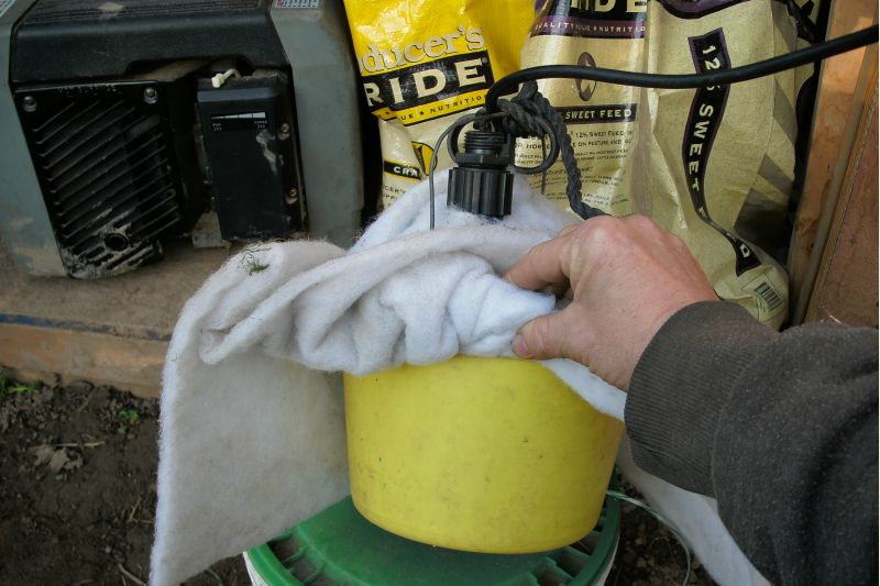

I do quite often when the creek is at the right conditions.It has to be flowing clean and clear.My pump is set inside a bucket with 5 micron filter material over it.Once in the tank I treat it with Clorox bleach.I don't drink or cook with this water.I bring in a couple of gallons of pottable water for that.
