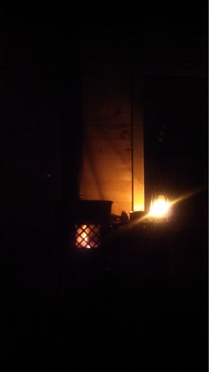

CootersShabin
# Posted: 27 Nov 2013 12:11pm - Edited by: CootersShabin
I just want to follow up here. The Riser idea seemed to work perfect on our little Jotul 602. It got some use over the opener for Deer Season, and it was nice having the Stove top up higher off the floor as well as creating a space under the stove (for warming things) that is off the floor.
Steve and MtnDon, I plan to see how a few weekends go up there this Winter, but I do suspect I may swap the lowest section of Double-Wall with Single at some point. We'll see. We got the building up beyond 60 each night (which is more than fine with me), but outside temps weren't all that challenging. However, we were hunting all day, so I am anxious to see how it does heating up the place with a continuous fire over a weekend (which may happen during Black-Powder....we don't stay out all day usually then).
