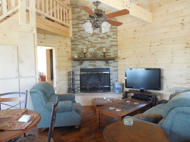

Our fireplace is the focal point of our place and our primary heat source.
While I did install a propane wall heater as a back up heating source, the fireplace is what we will be using 90% of the time.

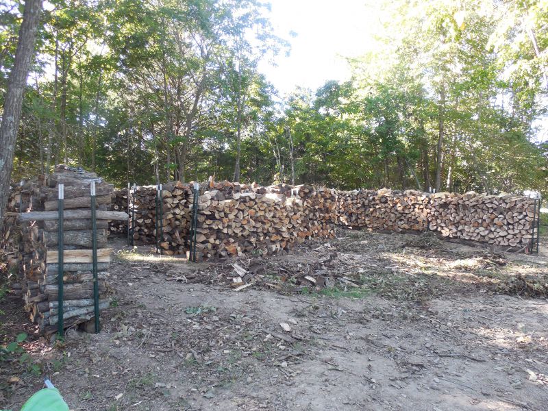

With over 14 acres (we just bought the 4 acre parcel next to us) of recently logged property, there is a huge supply of already downed trees and such to supply us with wood to burn for quite some time.
I can't imagine having a place like this without a wood fire burning on cold, snowy nights.
It does, however, take up a lot of real estate in a small place. 7 cords we split & stacked last weekend
|  Our fireplace

Quoting: MJW 7 cords we split & stacked last weekend
Maybe it's because we are in a dry and thus wildfire prone area I don't like seeing that much firewood in one place. There was a fire adjacent to our property May 2009. It came right up to 5 or 6 cords we had stacked in a long row. Most of that went up in a huge fire. Scorched and killed 75 foot pine tree tops. Now we have a small ready use woodshed near the barn, but not too close. Plus several stacks scattered around. Old corrugated roofing tin makes a good top cover... helps keep some rain/snow off the wood. Just a thought for the next wood you cut/stack.

When I saw all that wood my back started to hurt but like Don I too tend to spread the wood out, not so much for fire protection but I typically am cutting up a fallen tree as I only burn downed or standing deadwood trees so I just stash it in place till needed.
I had a main supply which is several months worth then I have a ready supply (2 month) which is stored in a separate insulated shed close to the cabin with dry lighted splitting area while the rest is stashed under plastic corrugated panels till needed (squirrels like it too), good dry cover for them.
My wood use is typically just shy of a cord of wood per season.
This fall I gave the wood to neighbors with efficient stoves (funny that way) as I no longer need it but don't like seeing it wasted either.

Our woodpile is probably 100 - 150 ft from our actual house.
Don't think forest fires are a problem here but I guess there is always a first time.
My back hurts, too, groingo. Don't think we will be doing that much at one time again any time soon.
