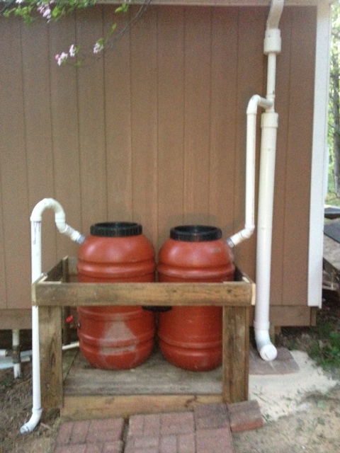

I set up a rain water cistern system for my remote mountainside cabin. It has worked great so far. I used a first flush sytem with screened gutter guard to filter the water. I then plumbed in a shurflo on demand pump to supply my kitchen sink and plan to plumb it to a tankless water heater for the shower in the future. Here is a pic of my set up and a link to explain the basic setup.

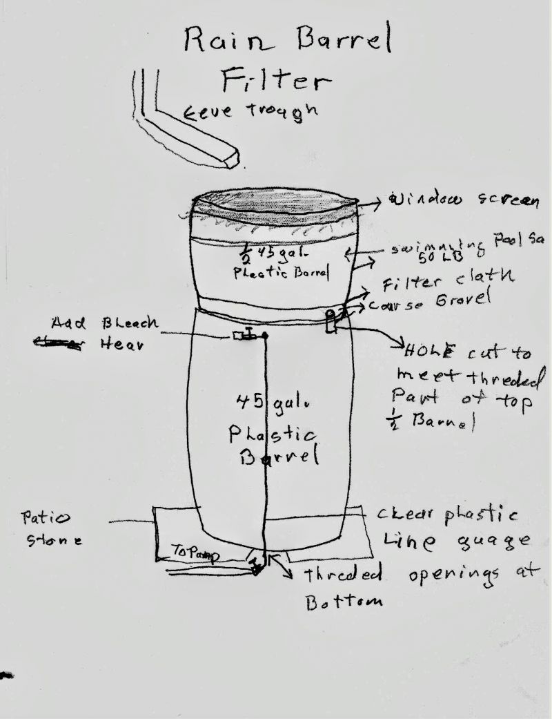

# Posted: 5 Oct 2013 09:46pm - Edited by: Just
Reply Quote

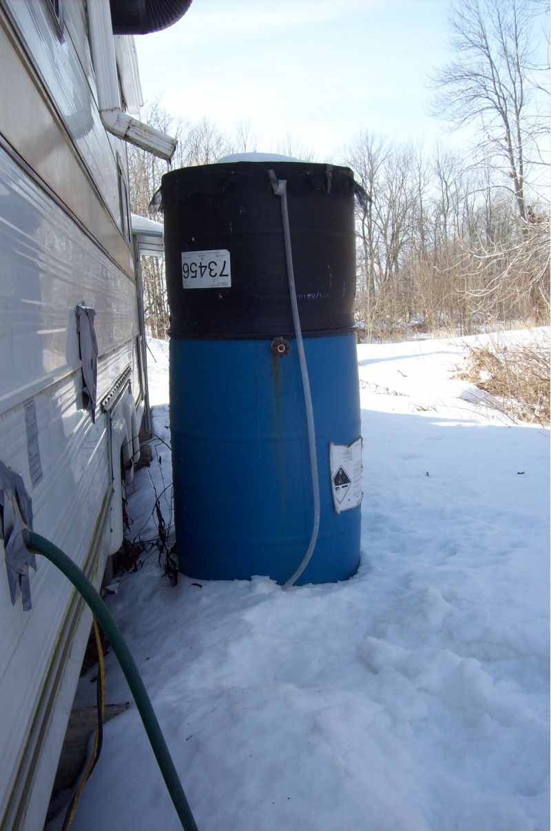

WE are low tec .WE ADD 2 table spoons of bleech once a week . use it for every thing but drinking for that we boil it then use it. Taste great very clear .no one has got sick in 7 years of use.drain it in winter . 100_1592.jpg

Just, in your diagram does that say 50lbs swimming pool sand?
Are you basically sand filtering the water?

Yes and yes works very well . grows a bit of moss on top of the sand but have never had anything in the tank .you could bury the tank for winter use .

Someone posted about the green stuff on sand. The germans call it Schmutzdecke or some such. it's good stuff that kills bad stuff and along with the sand filter makes the water potable. according to an UN study. see http://en.wikipedia.org/wiki/Slow_sand_filter
Nice pic/graphic Just. That's a nice system you have there.

It and a used Surflow pump make a complete system for under a 100$ .
