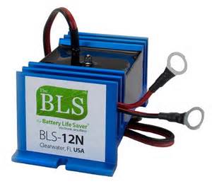

I recently added a BLS 12V desulfator to my (7) battery bank. From what I've seen on YouTube it seemed like a good idea. The science seems sound and anything that extends battery life has to be good... right? I use a Phocos charge controller and just wonder if the desulfator is redundant.
Anyone have any experience with desulfators and solar banks?

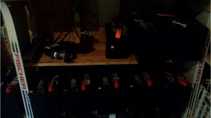

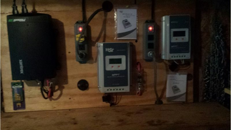

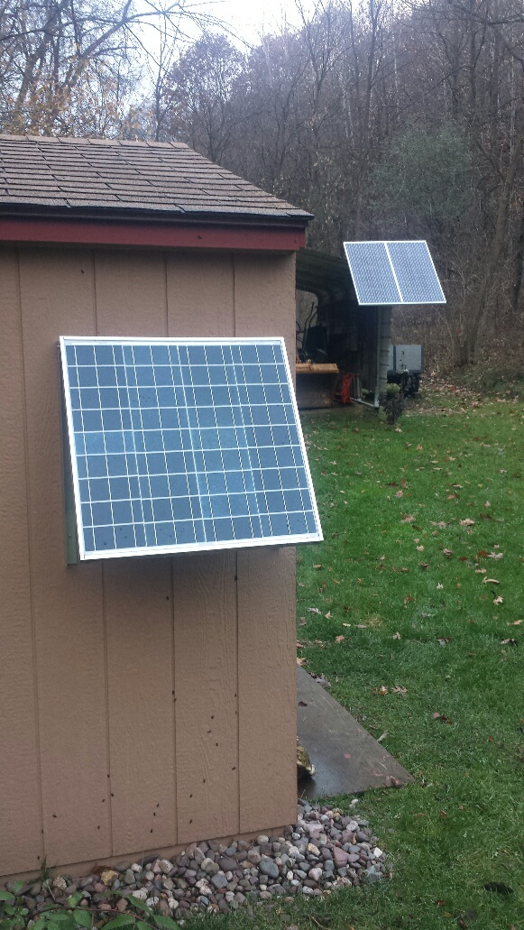

Four+ years later my battery bank is still going strong. I haven't performed any testing on the batteries but the lights, composting toilet, and TV are still running (mostly weekends). My previous bank of marine batteries lasted about 7 years...we'll see. I also recently added a PowerPulse desulfator to my two back up batteries. If the desulfators can add a few extra years they're worth it in my mind. Batteries.jpg
