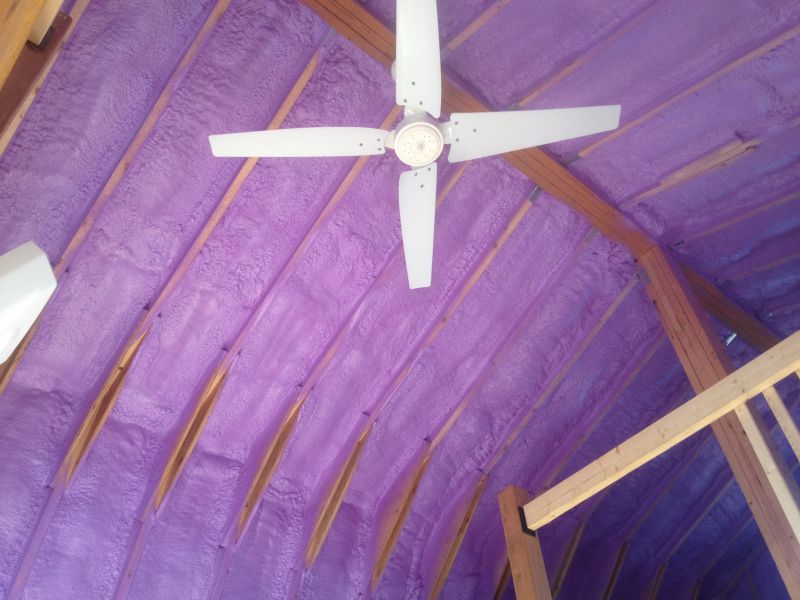

The 2 ac lights I am running are now on the inverter. All the rest of my lighting is 12vdc I could wire them back into the breaker panel to run from the generator only but we like to run the ceiling fan. Here is a thought... Can I wire the ceiling fan for 12vdc? Or should I just buy a 12vdc ceiling fan?

A 110-120 VAC ceiling fan needs that; will not work on DC. There are DC fans made. RCH is the brand we have; the one with the airfoil blades. It is much more efficient than the typical flat paddle blade. We have the variable speed control as well. Love it!
Fully Agree! Great fan. Costly when you add in the speed controller but works great and really a miser on power.

Thanks for the info on the fan, only downfall i see with it is that it doesnt have a built in light.

Yeah, but it sure beats any AC fan on power use. No light available for it either in case you are wondering. IMO, ceiling lights don't distribute the light well enough to be really useeful when one is trying to be careful about power use. We use a number of desk / table lamps and some under the cabinet strips at the kitchen counter.

These fans are really well designed for 12/24 volt with a very small draw but lots of air. Specs for the 4 blade are:
Amps: 0.5 @ 12 VDC; 0.78 @ 24 VDC
Watts: 2 @ 9 VDC; 4 @ 12 VDC; 15 @ 24 VDC
RPM: 66 @ 9 VDC; 83 @ 12 VDC; 117 @ 24 VDC
CFM: 1,221 @ 9 VDC; 1,820 @12 VDC; 3,600 @ 24 VDC
The speed controller will give you even more flexibility allowing you to run at a slower speed when it makes sense. It includes a reverse switch but the cyclone blades are not really designed to run in reverse.
