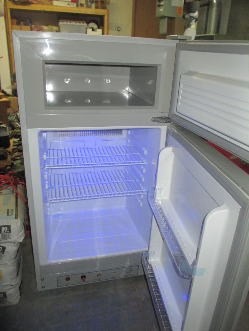

Does anyone have experience with a Koolatron Two Way Refrigerator?
I puruchased one yesterday from Home Depot, was on clearance for $200.00, normally $999.00. Couldn't pass up the price, just hope it is a good fridge.

RCaz
# Posted: 15 Oct 2013 03:53pm
Don, I have attached a picture of it. I wasn't able to find it online...

brad6006
# Posted: 21 Sep 2014 07:43pm
I have that exact fridge in Alaska. Someone GAVE it to me because it quit working. Several issues....
Home Depot says it was made for them, they gave up on Koolatron due to extremely poor quality and service, they tell me there will never be another Koolatron product in their stores.
I've tried calling Koolatron, they absolutely will not help with parts or questions. I hope you dont have warranty issues, I doubt you'll get help.
Mine came with a rubber supply hose, I wanted to change that out, so went to a propane store. The fittings made for that fridge arent interchangeable with anything. Threads are different, fittings are all odd sizes. So I had my local Cenex custom make a 6 inch section of rubber hose, adapted to a 3/8 in fitting that I can attach to my propane line.
I tried tipping it over after hearing the ammonia burp issues. No luck.
I got the pilot to light, but then discovered a bad thermocouple, that's the issue Im dealing with now. The fittings are smaller. So a universal one wont work. I've looked all over, Mr Heater seems to have the correct fitting, but i can only find a 12 inch thermocouple, that wont work. Talked to a heating supply house, they said cut the fitting on the thermocouple so I can get it off, slide it onto the copper tubing of a new thermocouple, and that may work. I've done this and will see if it works next month when I return to my cabin. If this doesnt work, I'll probably just junk the thing. I've spent WAY too much time screwing with an appliance that I've heard nothing good about. I would suggest you try and get a new thermocouple from Koolatron if you can, you'll eventually need it anyway. Heck, if you can get one, get one for me, seriously!! I'll pay you double what it cost you! Would also pay for a copy of our manual if you have one.
