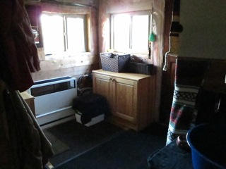

| hinterland Member
 | # Posted: 16 May 2014 08:40pm Reply
