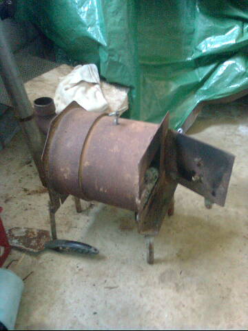

made mine from 10 in. well casing ,ends are steel plate all welded with 6011,pipe is 2 in. muffler pipe .keeps my truck camper warm for about 4 hours ,one needs to get up once every night. I burn dry hard wood cut and split about 6 in. long. Sits on the steel floor of the truck surrounded by a tin heat shield .
